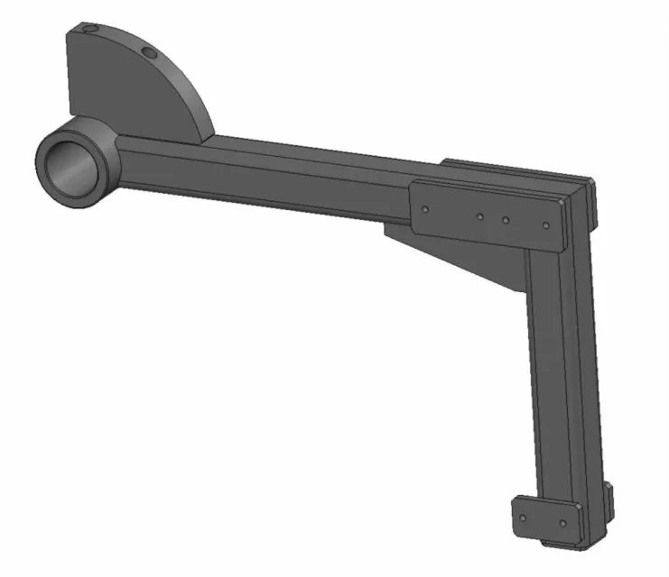

I am a "solidworkian infiltrate" but I would need help from vs.
a client of mine has v5 (it should be 20) and all the time I try to send him 3dxml that save from sw says he can't load them.
is a manufacturer who bought catia but uses it as a viewer (it has no internal technical office) and not knowing absolutely catia and the possibility or not that there are additional packages to manage 3dxml files I don't even know what to indicate to it.
I always solve it by converting steps but, between times of conversion and heaviness of files, there was a way to solve it would be very helpful.
I have already tried to contact the sw assistance but they pack in the dark as much as I do.
I can't call her:)
I come to the point.
would there be a pious soul working on catia (it should be the right section :) ) and that makes me the kindness to try to open the attached file?
in case it doesn't succeed, I will put my heart in peace and I will continue to convert bytes into step.
thank you in advance for any kind of support!

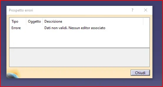

your file "try.3dxml" couldn't open it from the following error
1631096425628.pngI think it's a sw conversion problem in 3dxml
there are no additional packages to read 3dxml
if you carry a cathain catechin in 3dxml and then with catia open it.. It works.
Hello victorious,
same mistake that gives my client.
"No associated editor" led me to hope that there was a package to add.
Thank you so much for the time you dedicated to me!
Have a good day!

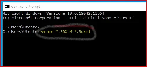

it is best to make a bat file in dos that renames 3dxml in 3dxml
Once I used them to rename the extension of cnc programs, now I forgot everything
by chance you know if here in the forum there is some discussion on the topic
as you have pointed out they can always come back useful
finestra of "cmd"
1631260565483.pngyou can create a .bat file with block notes the file must have "bat" extension
in its interior write
cd\ directory name (where the files to be renamed)
rename *.3dxml *.3dxml
as suggested @mcbramby
If you rename the 3dxlm (in case of product) in .zip, you can see the list of components from which the cpl is formed, but they are in 3drep format.
