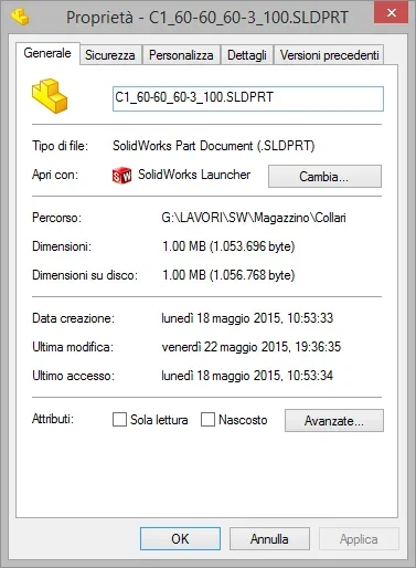

I have this problem: inexplicably in the folder there is no more distinction between files together. design and part, but they are all sldworks 2013 application, and I can't even see the preview.
Does anyone have ideas on how to restore visualization?
We also have a station like this and we have not yet succeeded. Perhaps we should unfortunately format.
in explore resources by making dx button "proper" on the files what it gives in "open with"?
I usually just want to distinguish files between axial parts and tables, without any preview and "open with" is set as attachment.
When I went to win7, something similar had happened to me, and it went well with that little thing.
everything solved, in fact finally now appeared solidworks launcher as an option for 'open with:' on the computer that had this problem I couldn't find this file, even doing research. mysteries mysteries mysteries mysteries mysteries mysteries mysteries mysteries mysteries mysteries mysteries mysteries mysteries mysteries mysteries mysteries mysteries mysteries mysteries mysteries mysteries mysteries mysteries mysteries mysteries myster mysteries mysteries mysteries myster myster mysteries mysteries mysteries mysteries mysteries mysteries myster mysteries myster myster myster myster myster myster myster myster mysteries myster mysteries mysteries mysteries mysteries myster myster mysteries myster mysteries myster myster mysteries myster myster myster myster myster myster myster myster myster myster myster myster myster myster mysteries myster myster mysteries mysteries myster mysteries myster mysteries mysteries mysteries mysteries myster myster mysteries mysteries myster mysteries mysteries myster mysteries myster myster myster myster
everything solved, it was enough to set a file by type (part, together, drawing) and now it is back to 'normality'.
