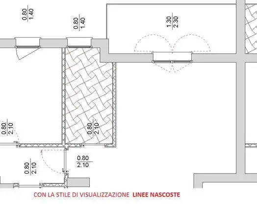

I have had a problem, that is:
with the > > detail > sampling command, I entered a deduction within an environment.
the problem is that if I use the wireframe display style the opening lines of the window are visible (fig 1).
if I change the display style in hidden lines the opening sign of the window is covered is not visible (fig 2).
I tried to solve the problem with the controls of the mode of modification of the sampling (fig 3) but the lines that indicate the opening of the window remain unseen.
Do I make mistakes in creating sampling or what???

ps: the "problem" described the finder both in the window, as already described, but also in the lower door to the environment where the restraint is placed.
