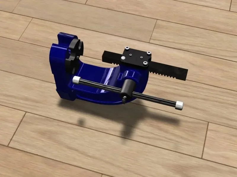

I attach the rendering of the bearing press present in inventor exercise files to verify whether it was my mistake or not, in fact some objects are imported in the correct sense,other no...
