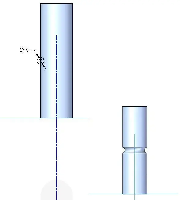

Hello.
I am at the very first experiences with solid edge for academic causes.
So I was practicing in an exercise proposed by prof!, well in the end I stumbled into a "change of revolution"!
What I can understand is that I never accept the axis of revolution.
It could be because the cylinder is full!
I send the link!
http://dma.dma.uniroma1.it/users/broggiato/cdm/roma/no/labcadlmer/dispense/labcad-meccanici-esercitazione6.pdfthe fact is that I should create a bevel in the engine shaft and nn I can understand how it looks!
please answer me..if you do us in the file is the "detail" the part I can do and for solution the prof uses the excavation of revolution. . Thank you! !

I tried to do it now and it goes.
I designed a cylinder
I then chose "exchange of revolution"
I drew a circle on the line that identifies the cylinder cap, the center of the circle must stand on the cylindrical cloak
I ran the dig.
see pictures
