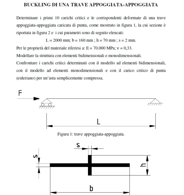

Immagine.webpHello everyone,
I am a mechanical engineering student struggling with this exercise and I hope you can clarify my doubts.
From the sixth load condition, the values calculated with the Eulerian critical load do not approach (they have too high deviation) with those calculated by the software with the beam 188 element.
I think I have some problems maybe in assembling the constraints correctly.
the version of softeware is 17.2
I carried out the exercise as follows:

View attachment 46294Hello everyone,

I simply repeated everything I had done, but instead of using the 188 I used the beam 4, which although not present in the library of the elements in reality I found that inserting it as string in the bar I gave it. with 188 I could not bind it well I think because I had too many degrees of freedom for knot, while using the other element was easier. It's been time since I did the exercise I don't remember exactly how I bind, but these days I place some screens.
