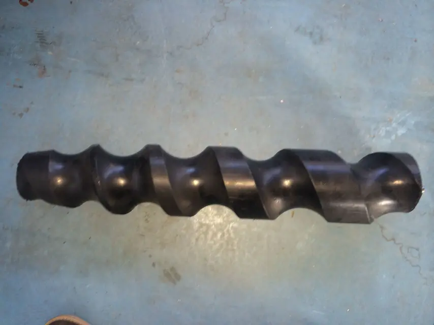

Good morning, I am performing some reliefs on a bottle labeling machine, I arrived at the final stage, that is the relief and drawing in dwg of the coclea for the incoming transport of the bottles. I'm going out crazy despite having fundamental odds. attached I send a photo. how do you build in 2d? thanks to all

that should be a variable step-by-step and incoming cochlea I think it's conical. I made it but not in 2d according to me you should get (if you have not yet done it) the steps for each spire and say the primitive diameter where the bottle travels the inlet and exit diameter and then the drawings and the diameter of the throat where the bottle flows. So much for those who build it are enough for them to make the spiral and so if the design is not so true. I do this when I pick them up and big problems I never had.

I quote your answer, in the end it is done so... my problem was that in drawing I wanted to represent the curves that the spires form, however, since it is not for those who build it I stop with the design... I do not quoto the massivandermeyde answer, and smile a little... thank you rotten anyway. . .
