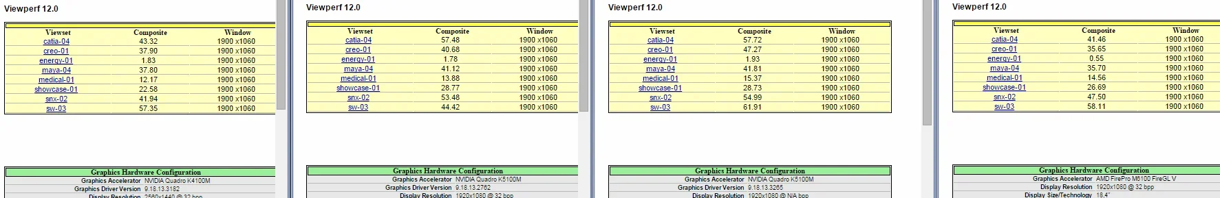

I attach an image for comparison between k4100-k5100-m6100 (it was taken from the site spec.org the bench of m6100 is that of my precision m6800.
specviewperf12.webpgood choice :smile:
