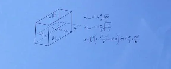

Hello everyone, I'm a student of ansys mechanical apdl. I've been assigned this exercise but I don't even know where to start, could anyone explain the steps to me? or someone gives me a video tutorial on how to do it? It's okay even if you send me the .txt file directly so I can study the code. thanks infinitely, the track is:
calculates the stress intensity factor for a semielliptic clique loaded so the (in two points: at the bottom of the clique and on the surface).WhatsApp Image 2019-08-26 at 09.40.50.webp
