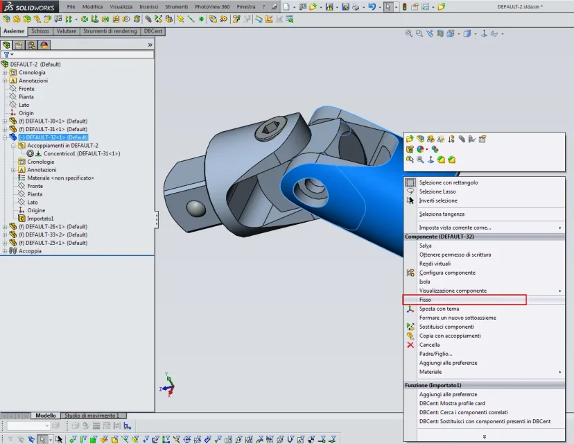

I have this set (see pdf attached).
I coupled the 2 components, but I need to lock the component with the socket, as it turns 360 °. How do I do that? I have inserted plans, axes, to mate together but nothing.
you must rend the fixed component, even if you have already given a bond (automatically it is suppressed)

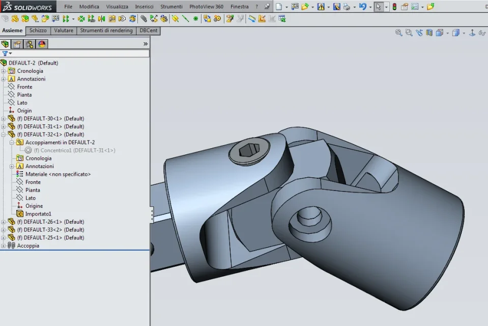

I attach images before and after.
if you have set the concentric bond to place the component with the socket you can use the rotation lock option
