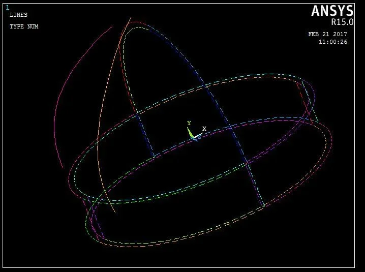

I would have a problem on ansys I created a dome with a drum and I have to lay around the cables second parallel and meridian but I do not know how to draw them, because through lines and points do not follow the trend of the dome itself. Does anyone know how I could do that?

Thank you for the answer! I actually have already tried the design road in cad but importing then in ansys does not recognize the lines of the parallels and merdians, while doing everything directly in ansys I can not give the lines the curvature of the dome and I do not know how to do it.
the goal should be to have the cables arranged as parallels and meridians to be able to assign them different characteristics and see the behavior of the dome with steel cables and kevlar and make comparison.

thank you for the answer!! I actually tried the path of the cad but I can't extrude the lines of sundials and parallels on the dome, with the command project geometry does not bring them back to me on the dome and I don't understand why!

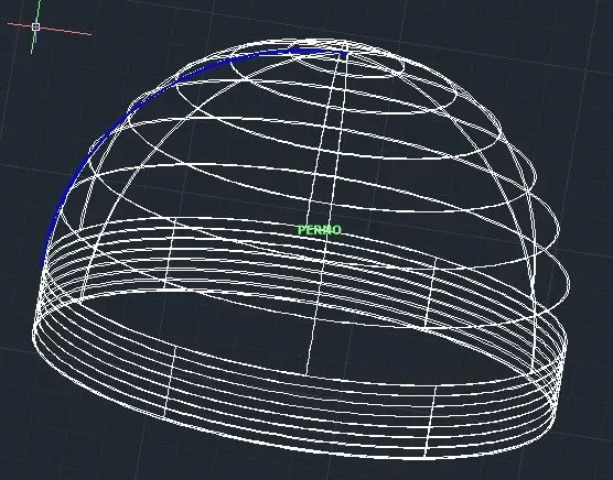

then the dome is in masonry so a simple solid will go well to which I will then ensign in ansys the characteristics, while the cables are enough of simple lines or if you succeed with a certain diameter so as to simulate a true tie. as software use autocad.
for the dome in autocad I created an arch and from that through revolution I got the outer surface of the dome, to which I added the internal one through offset of the arc of about twenty cm. However in this way I do not recognize the dome as solid but as surfaces and I do not know well how to convert them into solid.
thanks already in advance!! :smile:cupolaautocad.webp

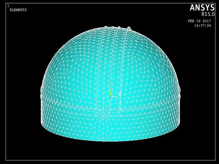

If the thickness of the dome is much smaller than the radius of the same (as I see), you should model it as a shell. As for the cables, even in this case I recommend you to use single-dimensional elements while I strongly disagree to use 3d elements as you should have a mesh with very small elements and everything would affect the system at a computational level.
to make the dome you have already solved, you just need to use the intermediate surface. when it comes to cables, it creates lines that represent the axis of the latter. for the sundials then make polar repetitions while for the parallels force the curves on floors placed at different heights of the dome.
