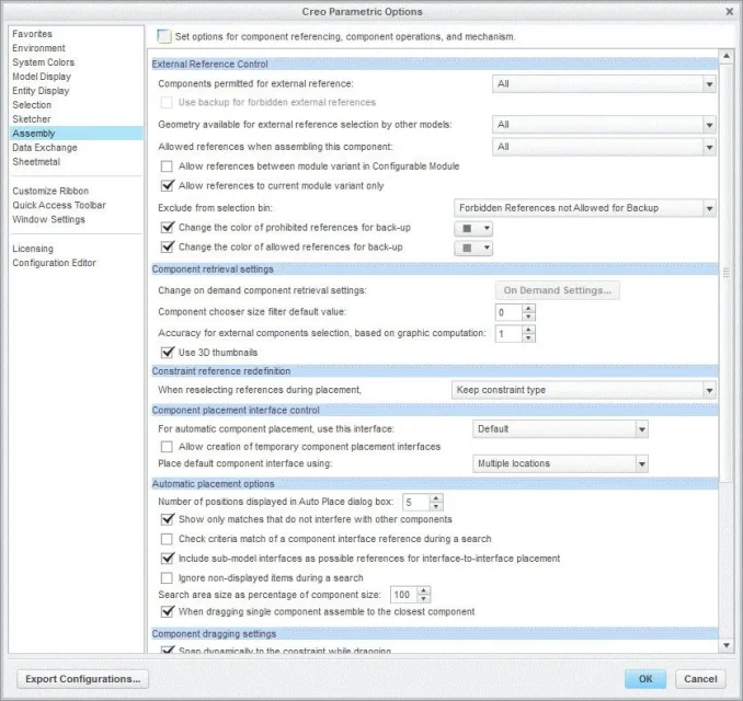

copy geometry question the motivation is that when you start I create you will not charge the tool_design_set.
to make it leave you have to go under:
file>options> licenses list and click tool_design_set.... made a macro so all the time you don't have to go around, I haven't figured out yet if there's a way to save it in the config.pro
the command should be part of the advanced assembly license (unless something has changed recently).
file\options assembly card and set in the first box (components permitted for external reference)
23.09.webpSalujah
Ozzyed
may be the license, but I remember a wildfire option that disabled external references, and that here I no longer find
You remember well!
If you want this change to be permanent, the option to set in the config.pro is as follows:
default_ext_ref_scope on all.
ps: copy geometry is always an option of advanced axiemic license.
