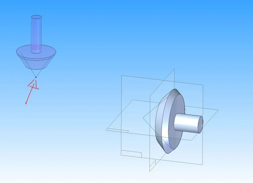

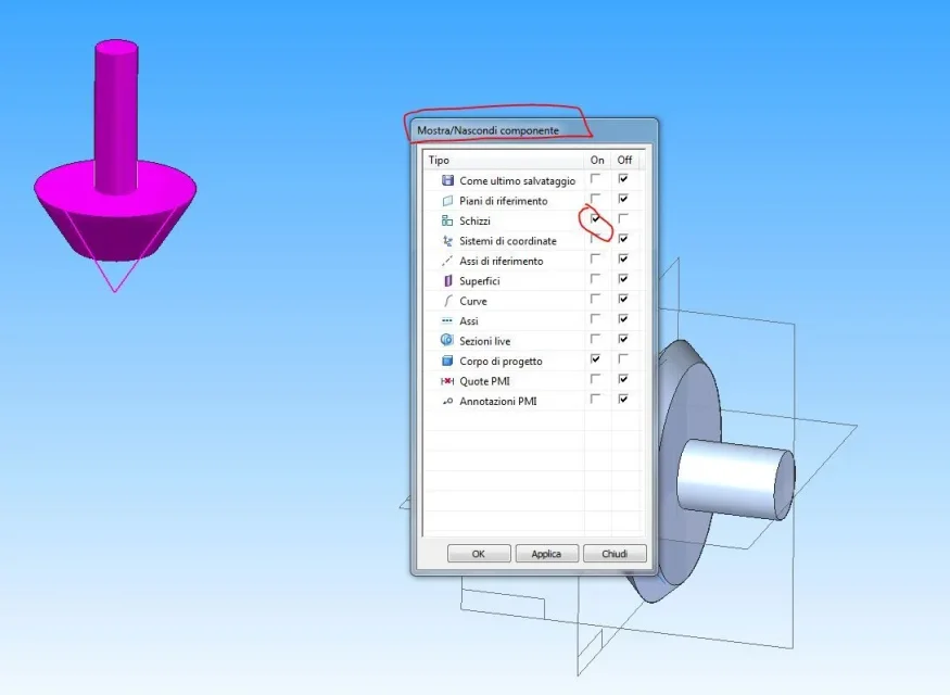

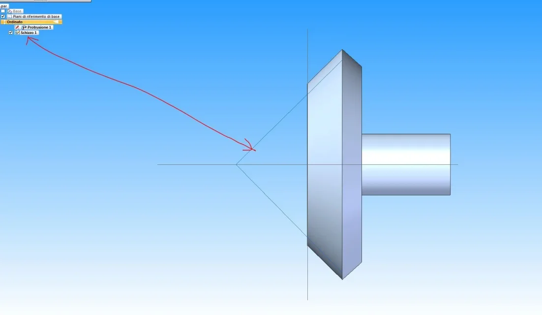

for these problems the ideal solution is to create within the individual models of sketches that serve then to couple them in a set, such as primitive diameters or in the case of conical pairs to connect the ridges in point 0 (zero). if you do it on both wheels when you insert them into the axieme you do nothing but select the model, right click shows/hides components, from the popping up sketch and from the ok so you view them and consequently you can mate them through these.

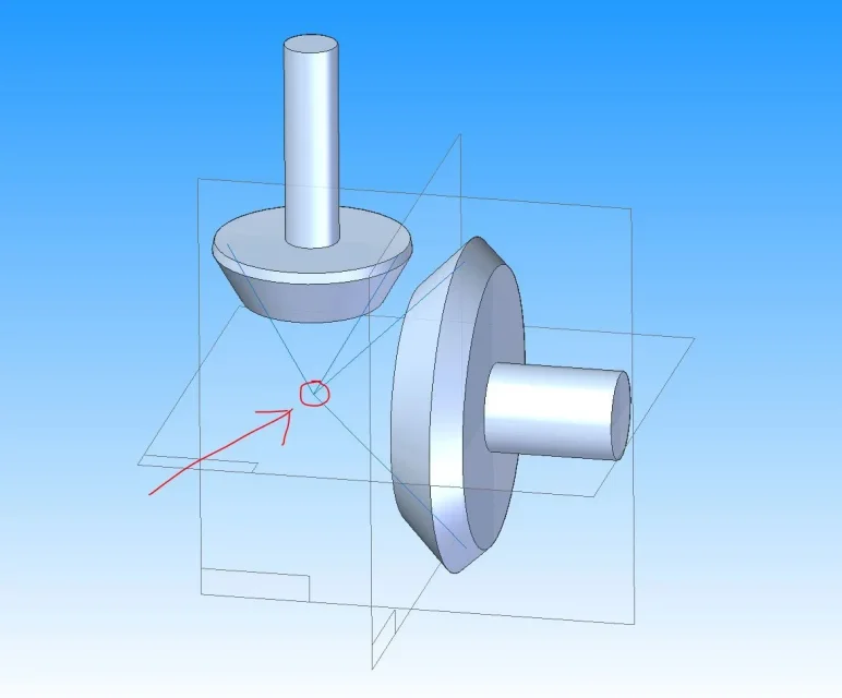

If you see, to conical couples, I put a sketch that starts from the primitive and intersects at a point called zero. doing so for both couples in the end you can assemble them by joining both sketches in the zero point.
the procedure is that you draw the conical couple, put a sketch of the extension to the zero point in the correct way (data that you get from the manuals of the conical pairs), insert the models in the axieme and for both selections, right click, show hide component, from the check on visual sketch and ok. when the sketches are visible you can assemble them by going to feel the zero point.

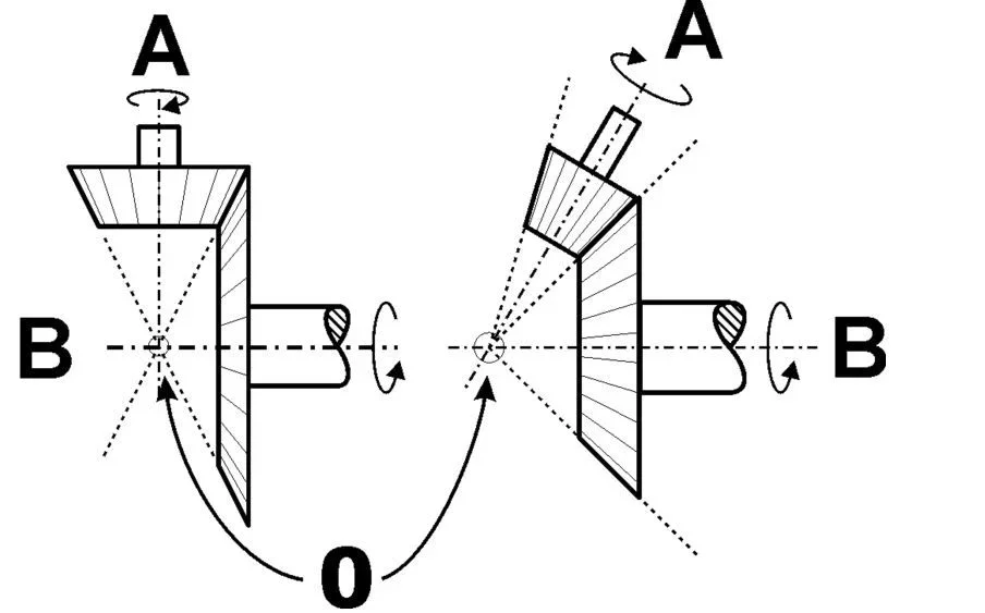

in the last image taken from the internet you understand what I mean and what you find in the manuals. the image shows the extension of the tooth crests, while on mine I started from the alleged primitive, for both cases the result is the same as the extensions converge at the same point.

studying the situation I managed to mate them... :p

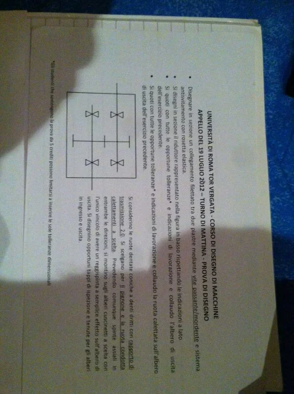

Sorry guys I have a doubt. Is it possible to have a gearbox whose transmission is given by dense conical wheels mounted on parallel shafts?
In theory if you have at least three wheels yes, but it would look like a differential.
if they exist on the market, if there are probably no more economic and/or performance systems.
in the photo that I put as it solves the transmission
an epicycloidal reducer with conical wheels that in fact I think is just a differential as written by wasp.
