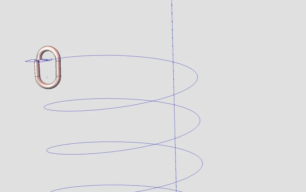

with that profile I don't think it's possible to do it as you would with a circular section spiral.I add an image, the solid must follow the spiral, creating a windingView attachment 32371
quoto marcof in toto.with that profile I don't think it's possible to do it as you would with a circular section spiral.
you can try to make a repetition of that part guided by the curve, setting the repeat step equal to the step that has the profile of that ring.

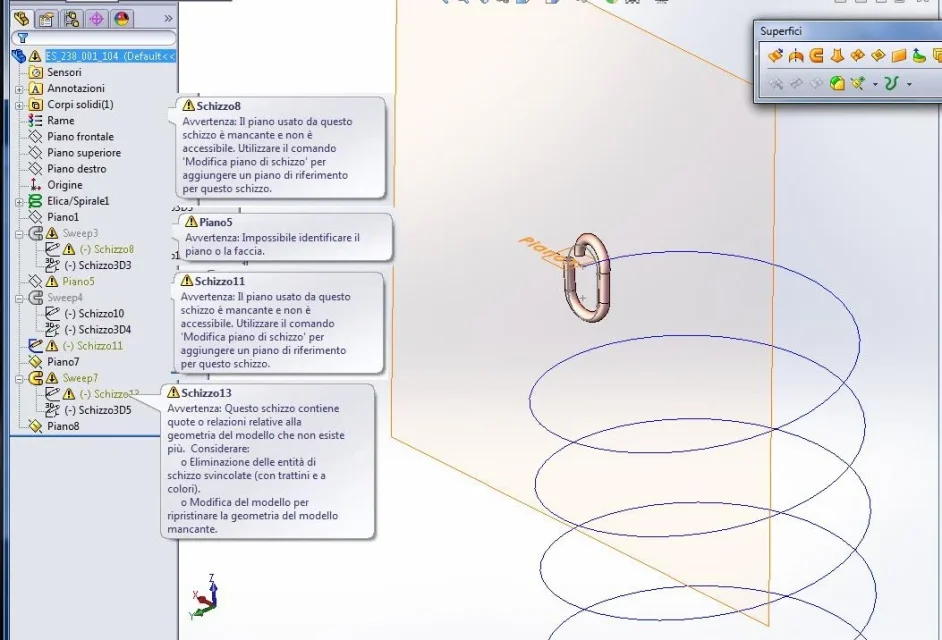

I have opened your file... don't take it, but I've never seen such a bad model (see image). errors everywhere (why didn't you fix them before sending it?) feature in error suppressed left there you don't know to do what (confonder us ideas? ...) you did not put a rag of altitude in the sketches (you then want to make the passage of repetition coincide with the step of the ring) not only, but sketches lack fundamental constraints such as the tangences between the lines and the bows. If you touch something, especially in sketch 3d, everything goes to cheerful donnine.I attach the file with the spiral and the second spiral to be created along the first spiral.

I tried to open it. I put my hands 2 minutes and I closed it. eheheI have opened your file... don't take it, but I've never seen such a bad model (see image). errors everywhere (why didn't you fix them before sending it?) feature in error suppressed left there you don't know to do what (confonder us ideas? ...) you did not put a rag of altitude in the sketches (you then want to make the passage of repetition coincide with the step of the ring) not only, but sketches lack fundamental constraints such as the tangences between the lines and the bows. If you touch something, especially in sketch 3d, everything goes to cheerful donnine.
What do you do, draw an arch, a line etc and give it value from the numeric casellin in the property manager how do you do with autocad so be sure that the sketch is really a wandering mine?
mail a file made as God commands that then we see to solve the problem of repetition.

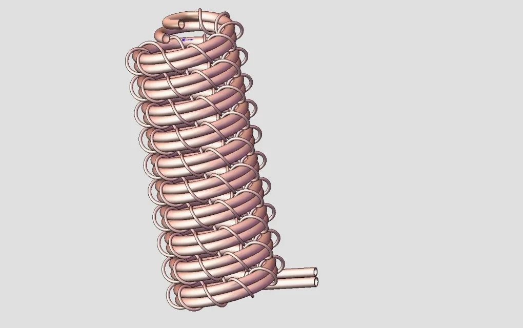

Sorry, but I had never worked with 3d curves, in this field I am self-taught it is three months that I work with solidworks, if I was a phenomenon I would not have asked for help. "the ring" I had created it to give an idea of the shape that had to have the second spiral braided in the first, I know that it is built badly, indeed it sucks, but it had to be just an idea of the form to get, maybe I explained badly. cmq I simplified the profile and this is the result. I put it as jpg because the zip file does not charge it 14mbI tried to open it. I put my hands 2 minutes and I closed it. ehehe
