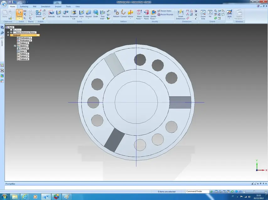

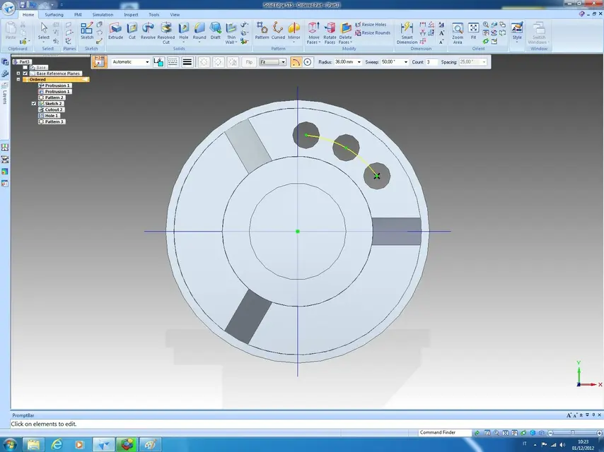

I have to create a circular set of holes, the first at 35° on the front floor, and the other 2 with step 25° on the first (see images).
then I would like to repeat all 3 holes with 120° pitch.
with pro-e I have 2 possibilities:
1.I make the first hole at 35°; I make the series of 3 holes (first hole + 2 instances) at 25°, in pro-and the first hole enters into the series; select the series just made and make the series at 120° of the 3 holes (set series).
2. I make the table series, fill a sheet type excel by inserting a line for each instance and the value of the angle taken in absolute respect to the front plane e.g.
2 60°
3
4 155°
5 180°...
I tried the first road (set series) even with solid edge and noticed that the first hole unlike pro-e is not incorporated into the series.
so I made the first hole at 35° (hole 1), then I made the series of 2 instances at 25° (pattern 3), I made the series of the first hole at 120° (pattern 5), and finally the series at 120° of the 25° holes (pattern 6).
the result has been achieved, but it seems to me Moroccan.
according to you experts, what is the best technique?
Is there anything similar to the pro-e table series?
thank you and have patience.
