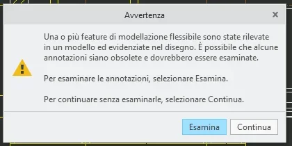

good morning to all, as from title I have a model on which flexible modeling was used (imported part and then modified), when I open the table display the following message:
1661929231360.webpConsider that I do not change anything compared to the previous opening and that by clicking on continues the design does not have any defects, someone knows how to explain to me how I see every reopen the message?
Put this on. :
creates hole in the 3d model with diameter 20 (quota symbol for examplep d0).
in the table shows altitude d0 diameter 20 and up here is not bad.
in the 3d model using flexible modeling increases the diameter to 25.
in the table the d0 is always 20 but in the real geometry the diameter is 25.
=> the warning you receive invites you to pay attention!
ciao @freexf , understood the function of the message, but in this specific case I do not have the "original" quota on the table, so you do not have to have the message or wrong? the quotas inserted in the table were placed directly on the drawing and should not suffer from obsolescence. It also does so both with the table of the particular itself and with all the boards of the asses that mount it. Am I wrong? Is there a way to avoid warning? Thanks again for the help and clarification! theoretically the scenario that you describe represents an abnormal use of flexible modeling, because if you have a value to change your hole or length that is there is no reason to introduce a further quota deriving from flexible modeling.
No one else? Is there a possibility to inhibit the message with a flag "do not show more in duturo" or something like that?

It is the "flexible modelling" that is a module aside and it is not "flexible rate".
I have shown a small situation in which that msg is thrown on screen, but in practice it is a feature indicator of "flexible modeling" that undergo the mathematics of changes not dependent on the odds that guide the model. So touching investigate model 3d. I don't know there's a chance to turn off the warning because it is indispensable to pay attention.
Oh, sorry, I got whistles for whistles. .
however add to the config.pro the following line:drawing_warn_if_flex_feature noand opla. .
of course, after that, you will no longer be notified,
and as they say from my side, "on coe rece" (on ears, pull ears, be careful in short... )

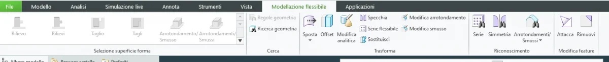

attention you do not have to activate creo flexibility on creo model, but use flexibility on an imported model, in practice the menu commands you see in the image1663142590860.webp
Thank you so much I immediately try!
:coffee::coffee: works perfectly, thank you very much for the help!
