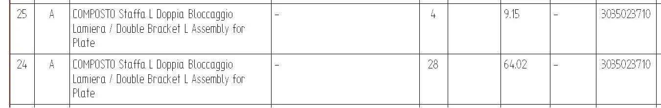

Hello everyone,
I have a problem and looking for the forum I did not find
If someone has already solved it.
making a table, in the list parts some components
equal have a different number of pellets, come in practice
counted as different pieces.
use if v.100

I think they are two distinct files, even if they are geometrically equal.
Maybe!
I made a replacement in the axieme,
of a component with this, then I expected the table
list parts grouped them, instead gave two positions of the same code.
Maybe you're right, it's a network path, the sever
He has an alias and shows it like two different folders.
Now I try to reconnect it.
thanks francesco,
was just the different path of the same file on the server.
