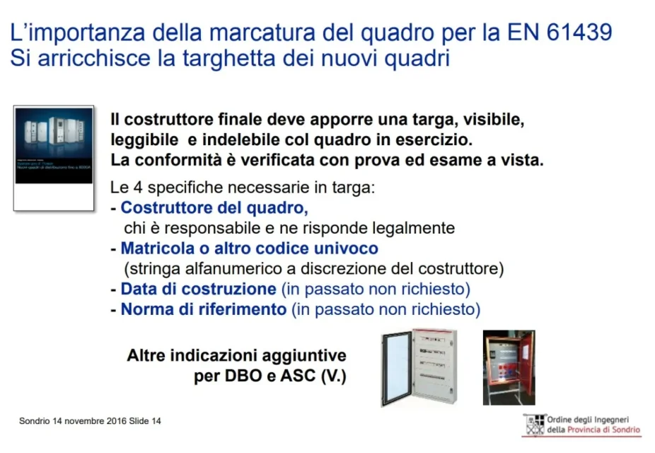

the standard cei en 60204-1 returns to paragraph 16.4 the marking of the equipment.
the norm reports: when possible it is fixed to the envelope a plate that reports... follow the data to put.
then specify that the information must be provided next to the arrival of the feeds
main.
but does this plate have to be placed inside or outside the closet?
I think it should be placed outside, as the data reported (tension, current, freshman and electric schema number, etc.) must be readable without opening the closet.
What do you think?
