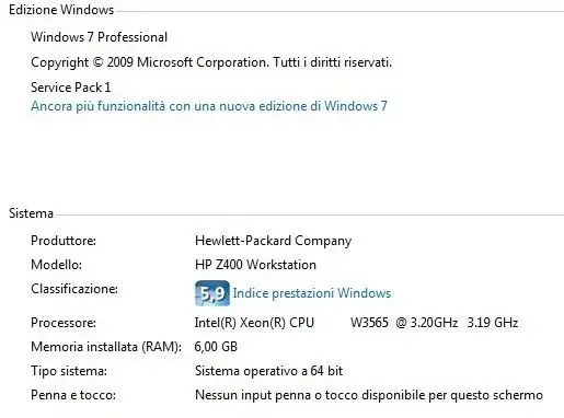

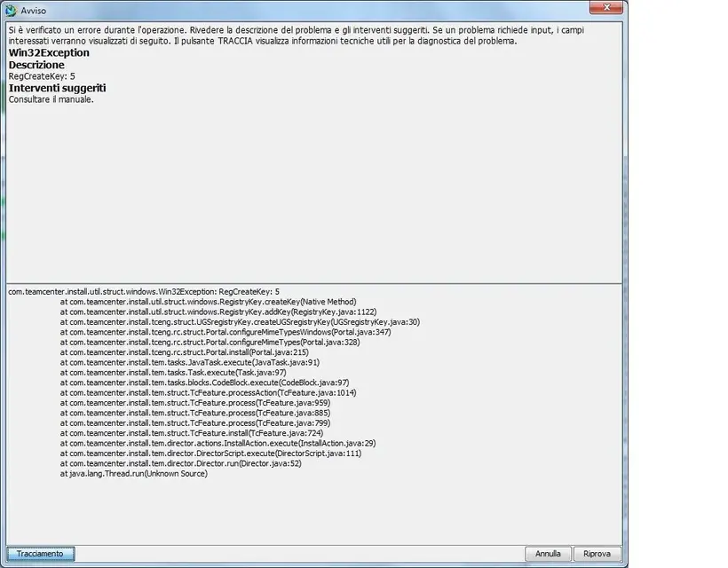

I found an error in installing a new teamcenter 8.1 workstation. in Windows 7 - 64 bit environment. I carry the type of error and configuration of the workstation in the images. precise that the workstation works as a client and the server works under windows 2000 with teamcenter 8.0. of course the installation was launched with the compatibility option for xp service pack3, among other things the same operating system of the old workstations where it worked correctly.
installation is made in rich -client 2 - tier configuration.
probably it's just a network configuration problem, but I don't know where to put my hands...

problem seems to be solved by forcing the installation as administrator, even if I was logged as administrator, I still have to get used to w7 ... cmq the installation now went to good end, even if I still have some connection problem to the server, but I think to solve it. .
