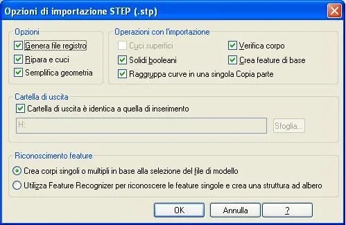

situation:
design electromandrino
individual parts "stock" do to my case
Htttp:/www.boschrexroth.com/dcc/vor...uage=en Gazhist=97568,go6068 faringid=p146809There is the file in step, good.
Exhaust, amount with sedge st (v100)... import but there are only the reference plans.
I have some import options. . idem.
SE.webpthe strange thing is that it is an old wildfire and a solid vetusto designer (2001) open the step properly displaying the whole tree of the parts. it does not solve even opening it in wf or sd and ri_salvandolo in step (at the end always empty tree).
suggestions?

thanks for the answers.
solve with last available mp.
the problem was on all steps, even those generated with option ap214 (standard automotive industry).
