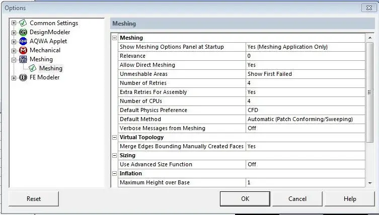

as I said use ansys 13, in the workbench there is a meshing environment that is called "meshing"...I don't know what algorithms you use since, always in the package of ansys, there are other more dated meshators like turbogrid or icem (never used....as they are at first weapons)
In any case even in that environment when I launch the mesh command, it only uses 25% cpu. but here I can't do as in fluent.. .
in the options menu there is a voice saying "number of cpus"; by default it is set 0.... but also after having put it to 4 (as shown in the attachment) nothing changes. .
It's normal. fluent uses multiple processors by subdividing the domain into small parts and assigning each one to a processor and using the mpi to communicate what happens to the interface.
Meshatura is a phase that unfortunately does not take advantage of multitreading, so you will always and only use a core.
