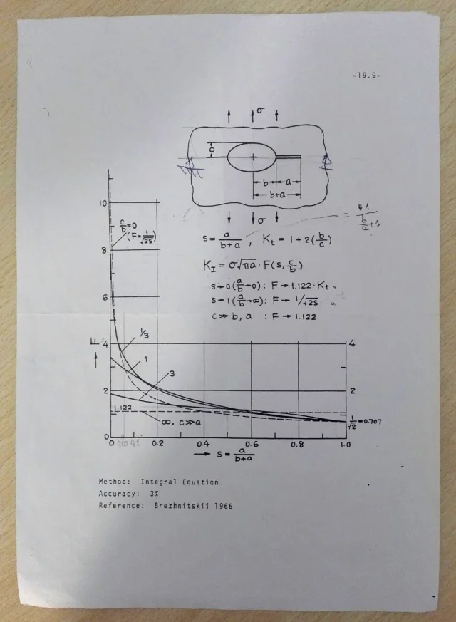

hi! :biggrin: I need help with ansys since I have no experience with the program... .
I have to study the behavior of the elliptical hole+fessure to vary the ratio s, for s that tends to zero and for s that tends to one. and I have to compare the factor of intensification of ki tensions (the one I echo from ansys and what I echo from the analytical solution of the sheet). How do I proceed?
Thank you very much in advance
on ansys mechanical (workbench interface) you have everything you need.
In particular, I recommend you look at the online help looking for "performing a fracture analysis".
