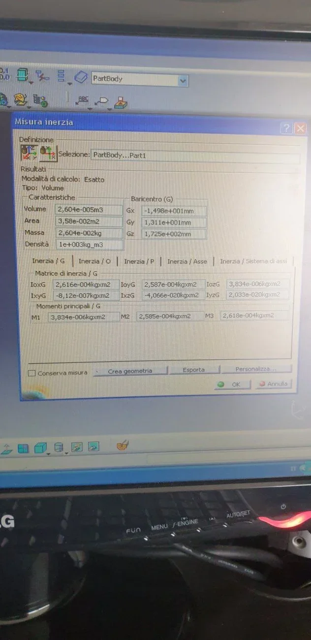

I designed a profile in mm that will be produced in abs.
34 cm high when I go sil weight symbol to calculate the weight, this...
I do not understand what the values of the
"2,604e-005m3"
the title of the question is " how can I calculate the specific weight"
we say that the specific weight you have to put it to calculate the weight.
So abs looks like 1.06 but I'm not sure.. control
you only have to enter 1.06 in the table under "density" and in the "mass" box the weight will appear
I wait for your blessing to see if you understand

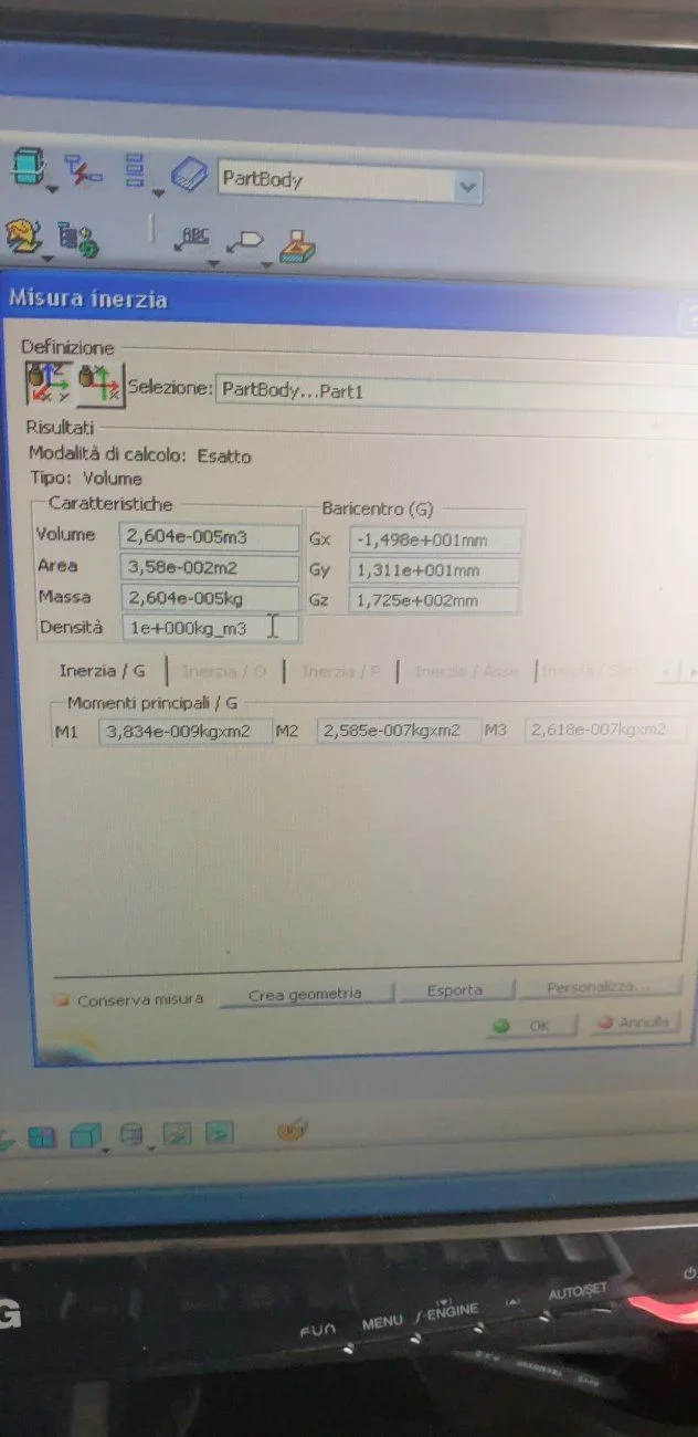

once put 1,06 on the density box I find this.. that if I have understood wrong is like saying 0,0010kg/m3 right?
:unsure: surely knew.. in his profile he wrote designer. :unsure: :unsure:
I have never calculated with catiav5 weights or similar things.. or always designed .. I registered to have more info. I use this software recently
the specific weight you have to apply it to the logical tree by choosing in the catalog of the materials of catia.
Then the actual weight of the object you have built will appear to you.
if you add or remove material from the object then the value will be updated.

You're right. But in catia by default there is no abs material and you have to build it with all the features, I avoided explaining this.. because, from the question made, it was evident that it was the first weapons
I saw now that you have density in m3... therefore the specific weight abs is 1.06cm3 you have to turn it into m3
