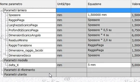

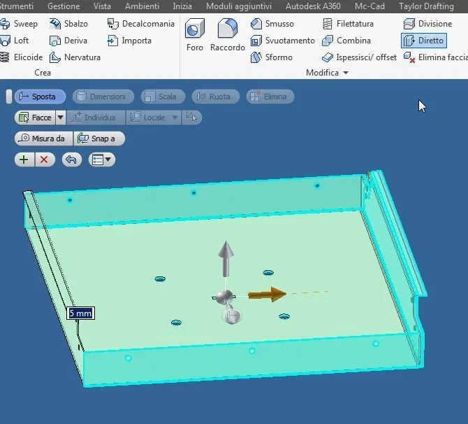

you have to use the "direct" command that will allow you to "stiar" each side similarly to autocad (crossing window to select)
if the value of "stira" parameterization by renameing the variable (e.g. delta_x, delta_y etc....) then by fx parameters, you can resize it to pleasure
Okay now I think I understand
View attachment 46270View attachment 46271
Thank you very much; at the end of the accounts I thought you had to use a more specific command, in fact I was wrong to use the "direct" command.
I'm sorry I complicated your life because of my question mail bad ahahaha thank you so much again!!!
