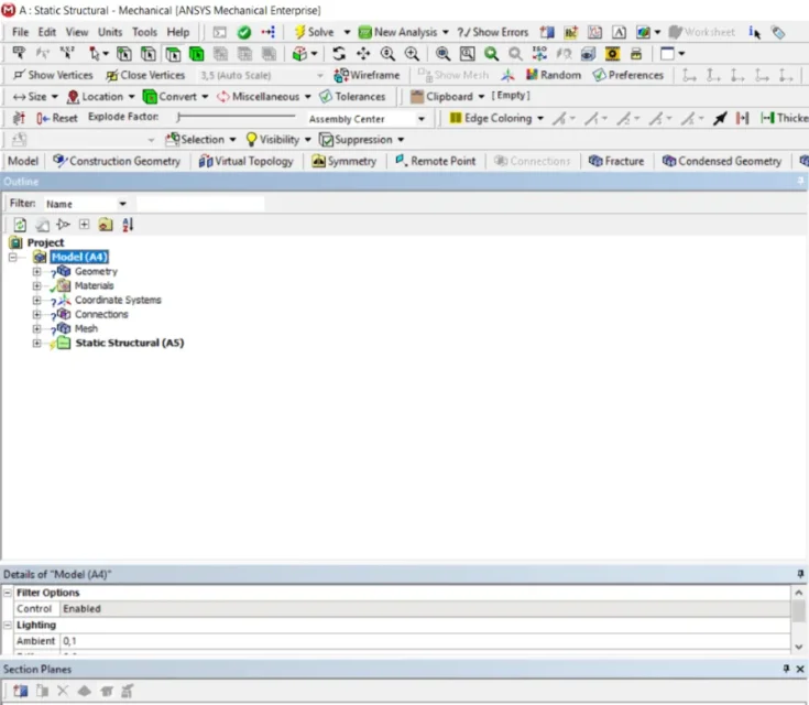

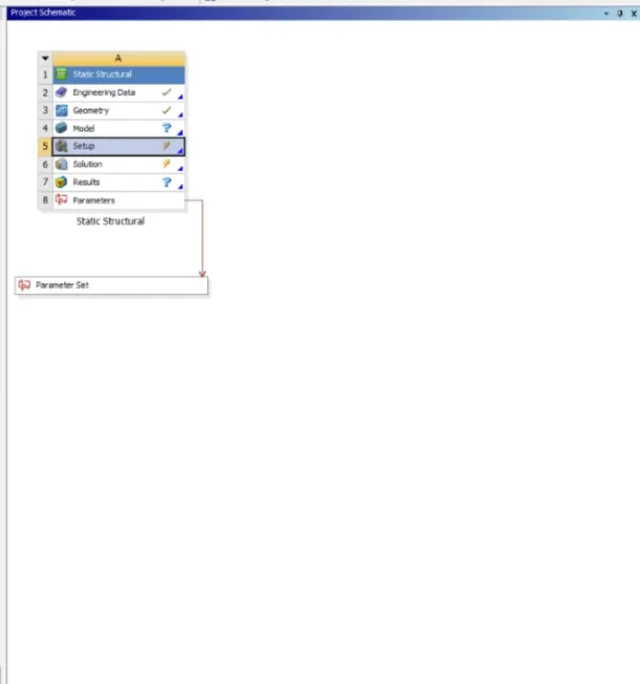

Hello, then the cad model created it with solidworks. I put it in the project of ansys and created the model; if I change the geometry on spaceclaim (even moving 1 mm of the component), click saves in space claim and refresh at the date in workbench, no longer recognizes me neither geometry nor boundary conditions. I also tried this procedure with different formats of the starting cad file. I really don't know what to do. I'll get you the pictures.

you have attached us photos of the control windows but you have not told us or shown anything about the model. Isn't something gone?
try to do the same process on a cube with n ink and strength. If not there is more problem you need to see what is happening to your model. This is a very simple test to do.

I got around the problem using design modeler instead of space claim. I realized the last modification I made with this software. Apparently if I change the cad with the same software doesn't bother me. I have to see if it's a problem with my model or not. Thank you all for your support and patience.
