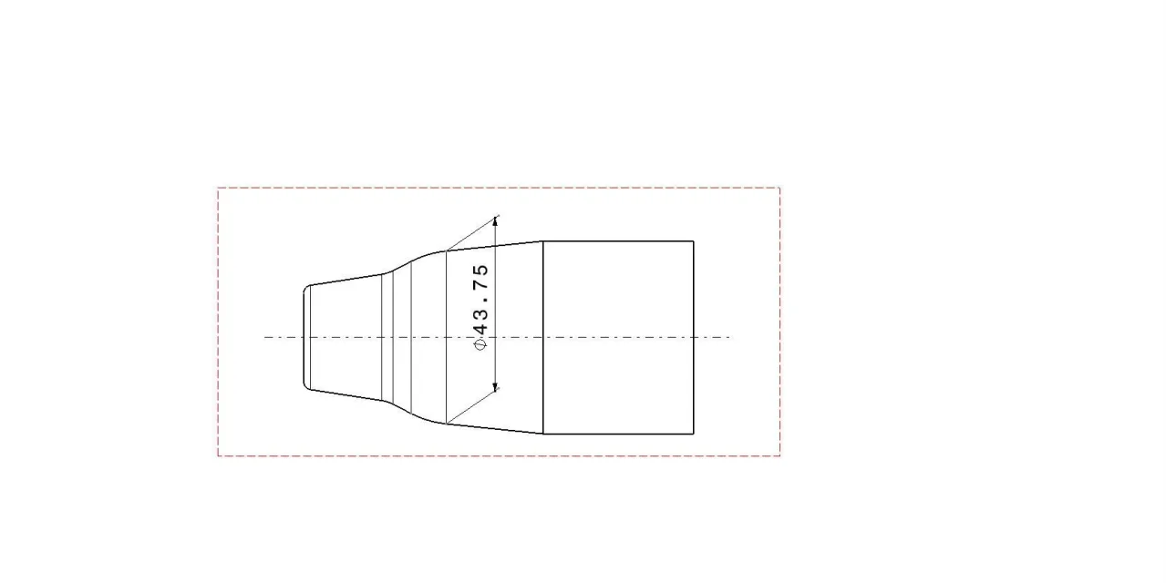

I have a quotation problem I would like to quote a diameter with inclined altitude as an attachment.
thanks for the answer

Cselez. quota--> quota ownership--> lnee and coordinated--> insert us value other than 0 in angle of projection lines.
valid for st5
on st6..
put the quota, then select it and with the button dx go on property.
in the window that will open you select the "lines and coordinated" page in the "project line" pane, change the angle from 0 to 45° or put the degrees you want and give the ok..
