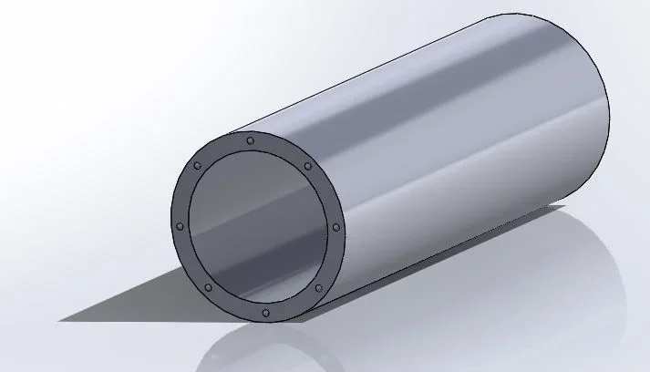

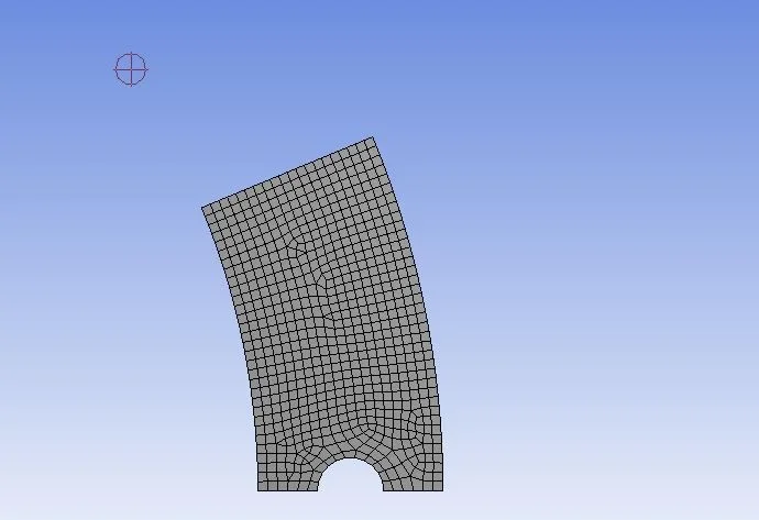

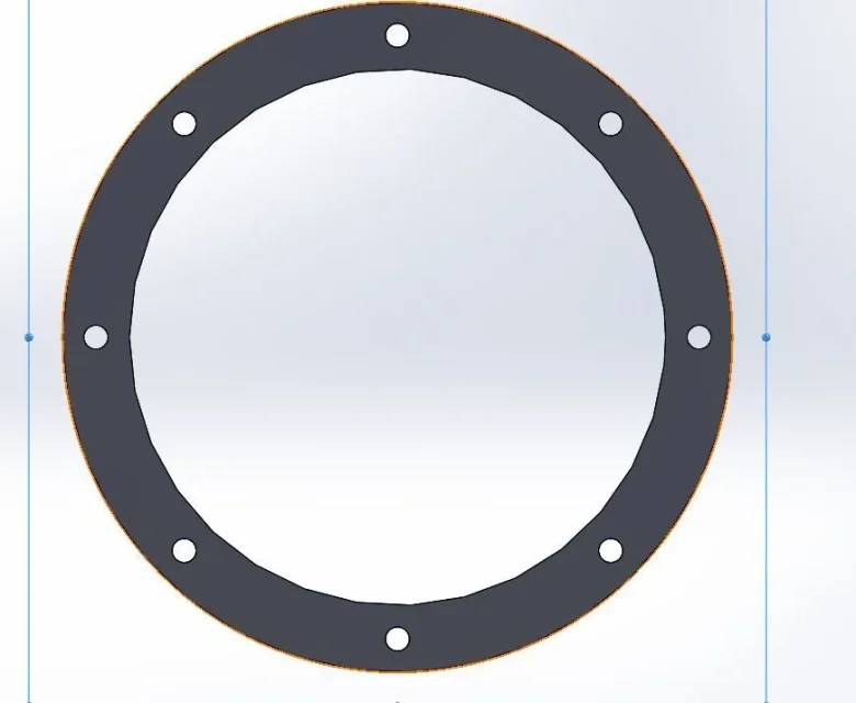

hello to all, I wanted to study this tank in perforated pressure (image 001), as a flat element. as the system is asymmetrical (for loads and constraints) it is possible to study only 1/8 (image 003), inserting symmetry constraints.
for the lower part just insert a planar symmetry, while for the upper part a radial symmetry.
Does anyone know how to insert it?
