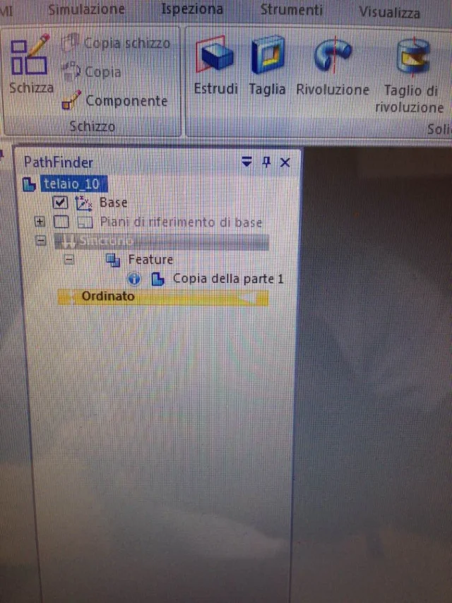

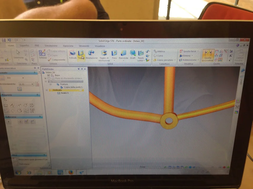

Hello, I have realized the surfaces of a bicycle frame with rhinoceros and I have to integrate it in solid edge st6 to complete it with some missing parts (such as the locking device of the saddle). the problem is that when I amount my file in iges format (.igs) in solid edge, it opens automatically in synchronous mode while I will have to do the missing works in order mode, also if I step in order mode (before that after importing the piece) keeps the imported part in synchronous while doing the new jobs in order. I tried to change the software settings but I don't find the way to open if in orderly mode. You know how I can solve this inconvenience? if I continue to carry out the work in order, can you create a part (and then a set) that was created in part in synchronous mode and partly in order?? Thank you in advance! !IMG_4343.webpIMG_4344.webp

In any case, having the important body on the ordered side would not give you any advantage as the work done on the ordered side happens after the synchronous part.
On the contrary, keeping the body important in the synchronous side would give you the advantage of being able to intervene when needed.
there are no indications to have "hybrid" parts, indeed in this way the two environments are exploited.
are of the opinion of be_on_edge, however if you do it you have to do the following steps:
Application button -- Solid Edge options -- Guide elements -- ordered
reboot if and part in order
