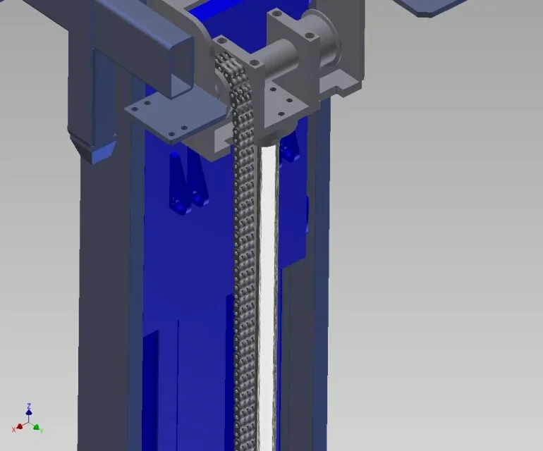

I am new to the forum, I press that I learned to use self-taught inventor, maybe I do not use it correctly,
Is there someone who can help me with the realization of a chain?
I tell you it is not a chain of transmission as the program means but a chain anchored on two points.
imagine the lifting chain of the forklift. made the chain shirts how can I handle it correctly?
You must bind it so that it has degrees of freedom as in the real case.
the movement becomes a consequence of the movement of the pieces to which it is connected.
If you place something you can better understand your question.
vista catena.webpThis is the chain, it should operate with the cylinder, see the chromed stem... in practice have I bound the shirts one with the other between the thorns of the shirts then? How should I proceed? Thank you.
What bond did you put?
You must bind the axis, so they have a way to rotate.
then you will win the tangent jerseys to the wheel on which they run.
It's to try and see the way he behaves

in addition to the constraints on each pin of the shirts, you will have to use the "transitional" bond, which does everything he wants and nothing you want.
That's right. Don't waste time.
