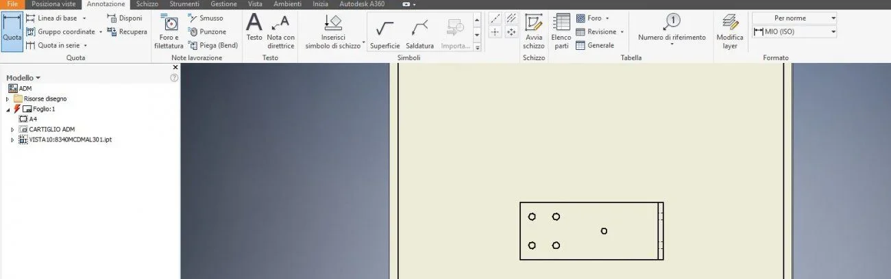

Good morning to all I'm washing in my template to set my quota style, I tried to read and perform compared to what was suggested in previous discussions, but I can't fix it.

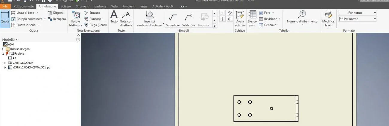

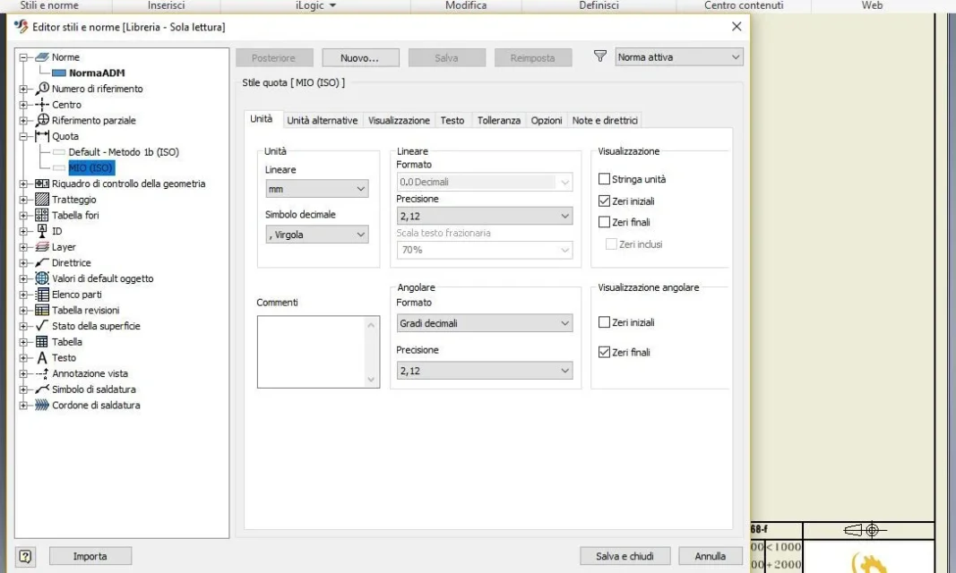

I set my quota style except and close (image 1 ) , I try to put the quotas back (always in the template) , but the quotas rest on for norms (image 2), I have to force each time mine (picture 3) only that exit from the quota command rests on for rules.

If you work with an active standard in the library, your share style you want is by default,
You must set it by default in the "default of the object" then save the norm in the library.
