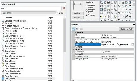

the command that the button (the icon) launches is _dimaligned.

wanting to return to the previous layer you can use this macro:^c^c(setq clay (getvar 'clayer)) -layer;_s;"quote";;_dimlinear (setvar 'clayer clay)compared to the acaddoc.lsp procedure I suggested, this has the disadvantage that must be replicated on all "buttons" and in case of exit from the command remains on the quota layer.
