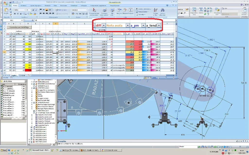

I made a macro excel-vba, simple that will revolutionize my way of design.
Objective: you want to evaluate different settings and scenarios, piloting quotas and reading others, to compare the results.
instructions on solidedge:
prepare a file (any environment) with odds or variables with known names.
keep the file open and displayed (activedocument)
istruzioni su excel. insert data
. if it does not already exist, create a table: table (ctrl+t)
. make sure that solid edge is open and active document is what contains odds or variables with corresponding names
. click on "simulator" button
. smiles
use of colors:
Table header cells are automatically formatted according to the following scheme:Warname1variable black/guide rateWarname2bluevariable/guided rateWarname3redvariable/quota not found on solid edge active documentvar name4Startname indicated in invalid excel (contains spaces)
Program in Fase Beta Not debugging. implied or explicit warranty: use at your own risk.
