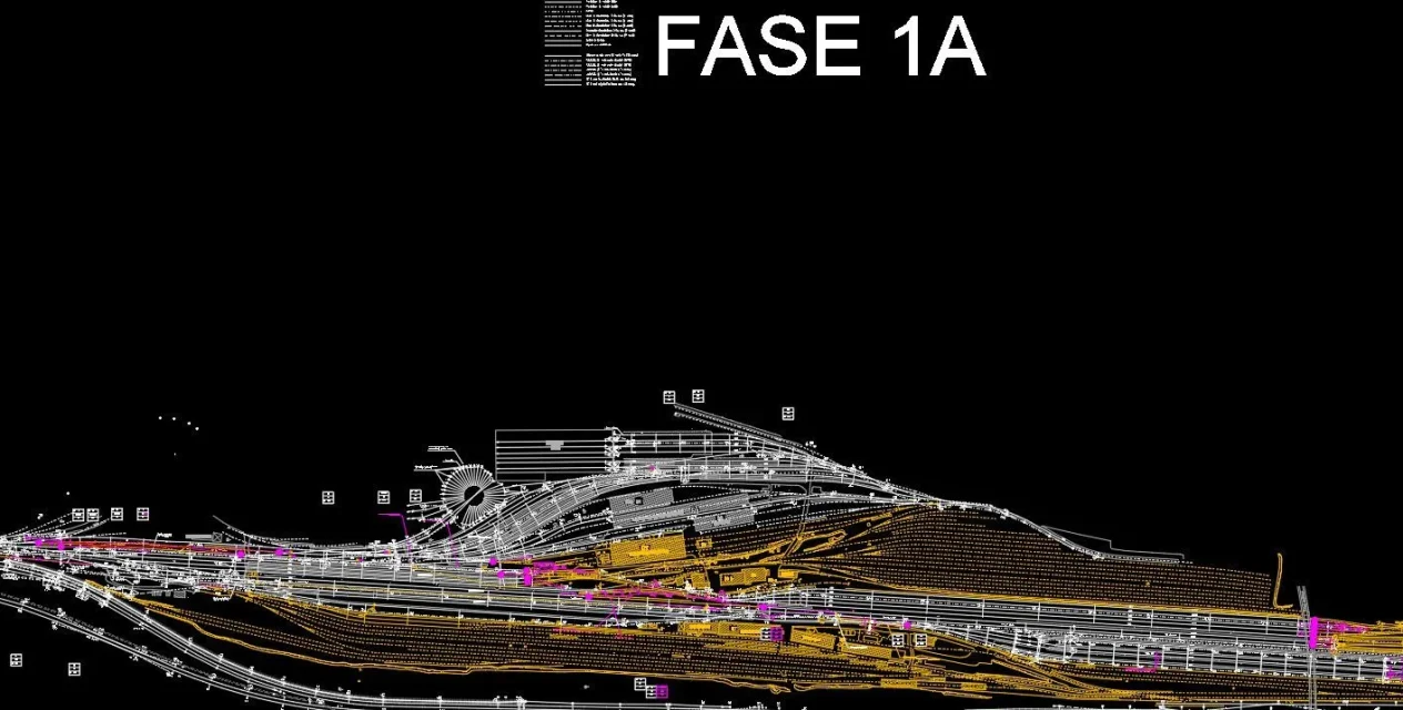

I am facing this problem:
I am working with planimetries with various very complex stages so I need to use layer states for each phase.
everything was organized in a single "work" design that I then go to save with name with activated the layer state of the respective phase.
and this is the true design part, then there are: the cartography, the legend, the file of the summary tables and the cartiglio file (always xrif).
my problem is that the real planimetry (electrical traction plant treatment for a railroad) has performed it my collaborator using both the layer state used by him and the one used in our office.
now, in the previous design versions we delivered the processed with our layer state and there was not even the problem of changing the layer state of the design in which the xrifs were inserted, but now our customer has requested to deliver the next revision of the processed with the layer state that uses our collaborator, that is the one below
but if I go to change the layer state (of the xrif because the file only acts as a " xrif container" and as a layout) on the model space the plan is displayed correctly while if I try to change the layer entering the window of the paper space also changes the xrif layer by turning them off (e.g. cartiglio and square) that have been inserted only in the paper space and change the view of some layers
under allego the etransmitter View attachment NT.05.00.C.ZZ.P8.LC.00.0.0.004.A - Standard.zip the correct visualization if you want to bang your head.
I'm sorry if I didn't explain myself well but it's all today that I'm glad and fused. :36_6_1:
thank you to those who will have the courage to light I am papyrus.
