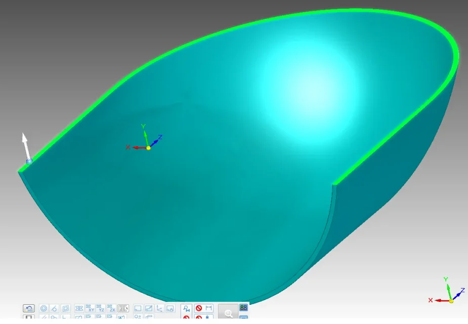

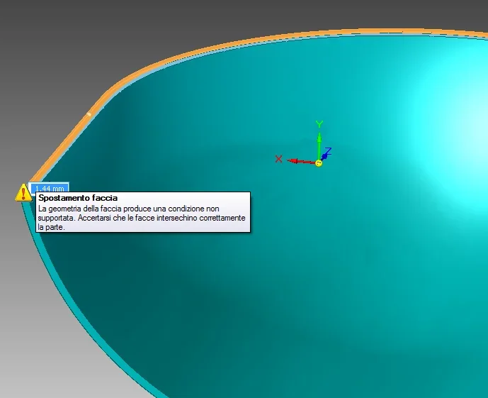

I am using st6 and I am having to raise the indicated plan of 1.2mm, but I go to banana math and I do not understand why. .
Can someone give me an explanation?1.webp3.webpthank you from now on for the kind help.

that body you built is defined by circle arches with fixed rays or spline?
If they are spline, I think that the command moves does not work for the impossibility of solid edge to predict (or rather, invent) portions of missing curved surfaces.

the solid was first generated in orderly mode, as thickness of a surface.the surface was created as bluesurfing... later it was converted into synchronous mode.
Do you think there might be a way to correct or allow modification? I tried to build a solid on it, but the problem remains. I tried to combine surfaces, solidifying them...but the problem persists. . .
I'd like to try to recover the solid if it was possible. When I used nx, I could shoot it, and often, so I would eliminate these math things. .
