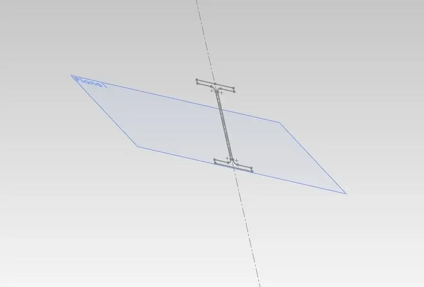

if you have to move it you have to open it by clicking the dx button, click the icon with the plan and the handle (change the sketch plan) and then click the new plan.I can't overturn the sketch you see on the tilted plane.

You searched bad and you don't even need to shake the net.I can't overturn the sketch you see on the tilted plane.

Thank you very much.if you have to move it you have to open it by clicking the dx button, click the icon with the plan and the handle (change the sketch plan) and then click the new plan.
if you need both you can create a derivative sketch by clicking the sketch, the plan and then click the derivative insert-> disk.
the second sketch is and remains a copy of the first, if you have to make changes you have to make on the first and the secret will have them accordingly.
If you need to undelete the sketch derived from the father you can click it with the dx button and selecting a derivation cancellation.

this move I can only do it on the top, front or right planes because from the feautre manager tree it makes me choose only those without giving me the possibility to select my personalised.if you have to move it you have to open it by clicking the dx button, click the icon with the plan and the handle (change the sketch plan) and then click the new plan.
but did the plans create them? and if you created them, in the aberration of the works are placed premium Of the sketch you want to move slowly?Then,
Is that right?
plans obviously created them but later.but did the plans create them? and if you created them, in the aberration of the works are placed premium Of the sketch you want to move slowly?
because if the plans you created them after The sketch you want to move is obvious that those plans, when you choose to "change the sketch plan", did not exist acora so you do not see them and if you check in the feature manager are suspended. in case you have to move the plans in question, if you can according to how you shaped the part, premium of the sketch to change

tried but they are blocked i.e. as soon as I try to drag them I appear the circle with the axis in the center (like the sign of the ban stop).tried as usual in windows to click and drag? ?
everything has a logic construction sequence, first floors and then sketches (if you don't take a sheet you don't have the support on which to draw, don't you?). If the plans you created them by leaning on existing bodies/geometries of course you will not be able to move them above (before) of these.

because you can't move the "sons" before the "fathers". If you do the sketch on the front floor then build the plans p1, p2, p3 etc. that are referred to geometry of the sketch obviously you cannot move them before that sketch, because then they would not find the geometry that created them.tried but they are blocked i.e. as soon as I try to drag them I appear the circle with the axis in the center (like the sign of the ban stop).
you tied the plan to some previous entities (magari belonging to the sketch), so it becomes "son" of vuella entities and you can't move an "son" entity before an "father" entity.tried but they are blocked i.e. as soon as I try to drag them I appear the circle with the axis in the center (like the sign of the ban stop).
