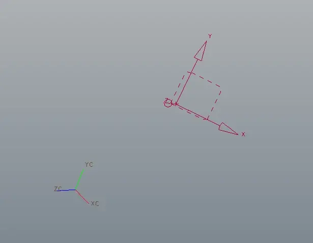

I have a set made up of many parts. without noticing I have "disappeared" the reference system of my group compared to that of the views.
In plain words, when I press the button on the known views (top, bottom, side, etc.) my object does not position in an orthogonal way compared to the screen but "stored" though its shape is absolutely regular.
I tried in every way to restore the initial situation but I can't.
Can you give me a hand?

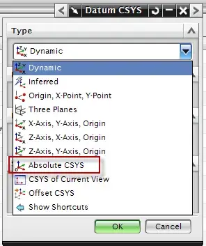

double click on the wcs and select the option indicated.
I attach image of your probable situation and the option to bring everything back to absolute values.
