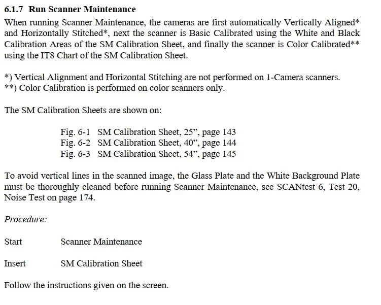

hi I recorded myself to tell you after a decade that the assistance teased you to get you to buy the kit at high price :rolleyes:
I attach a couple of shots from the service manual, which indicates that the sheet is the same for all countxes of the time (and also after)

I am in the same boat. I have inherited a Contex Cougar 36 that seems to be in good working order, but no calibration sheet was included. It seems the part number for the sheet I need is 6799D116. I've had no luck in locating one. The technical manual has a decent drawing of the layout of the board. The only things missing are the Agfa IT8 section and the gray area bars. The Agfa IT8 should be easy enough to swap in. But the gray values are unknown. Also unknown is if the pattern in the top right area is crisp and accurate enough in the drawing to work when attempting to create a replica calibration board. I may have to give it a try if I have no luck finding an original.
