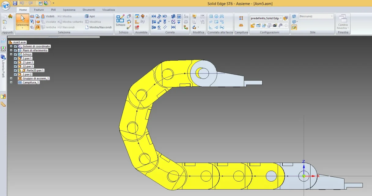

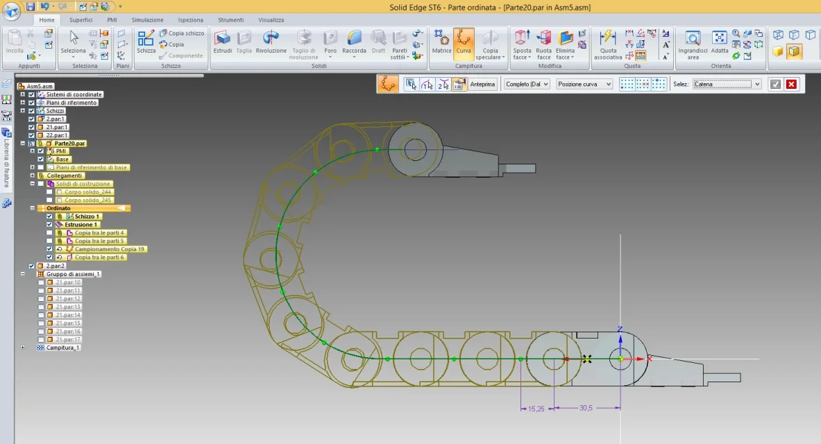

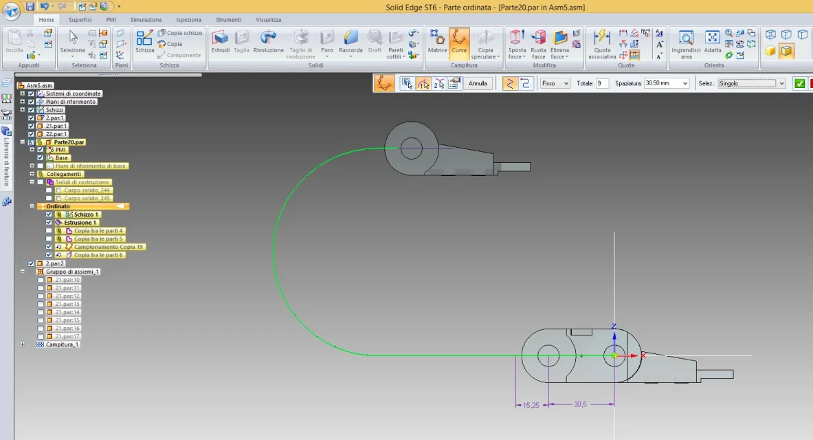

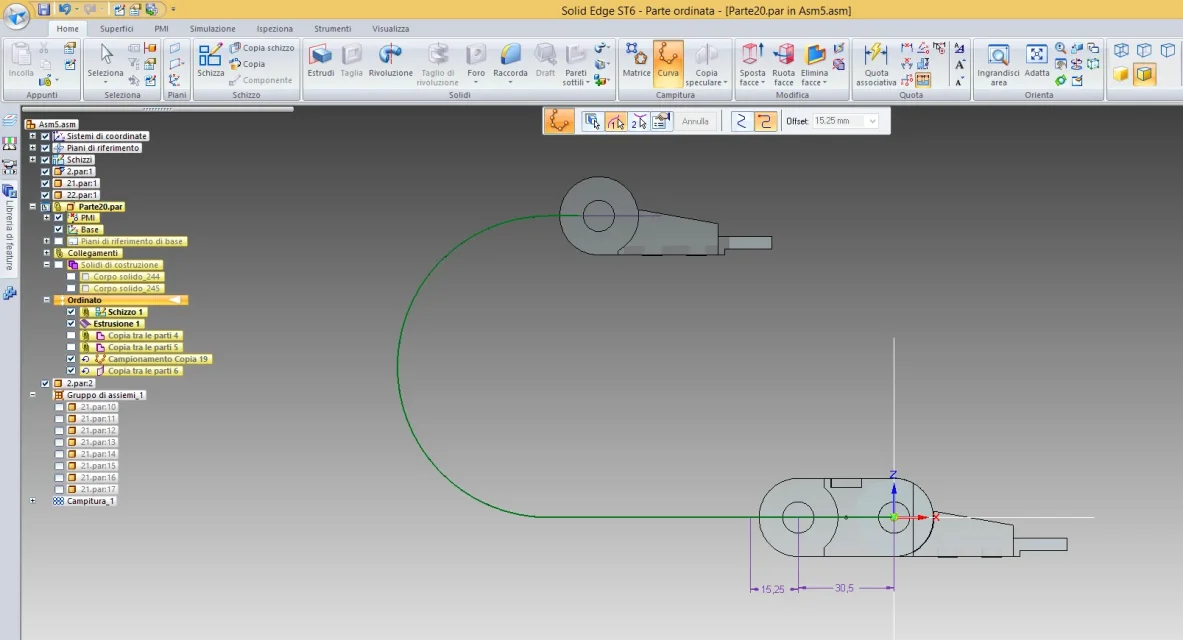

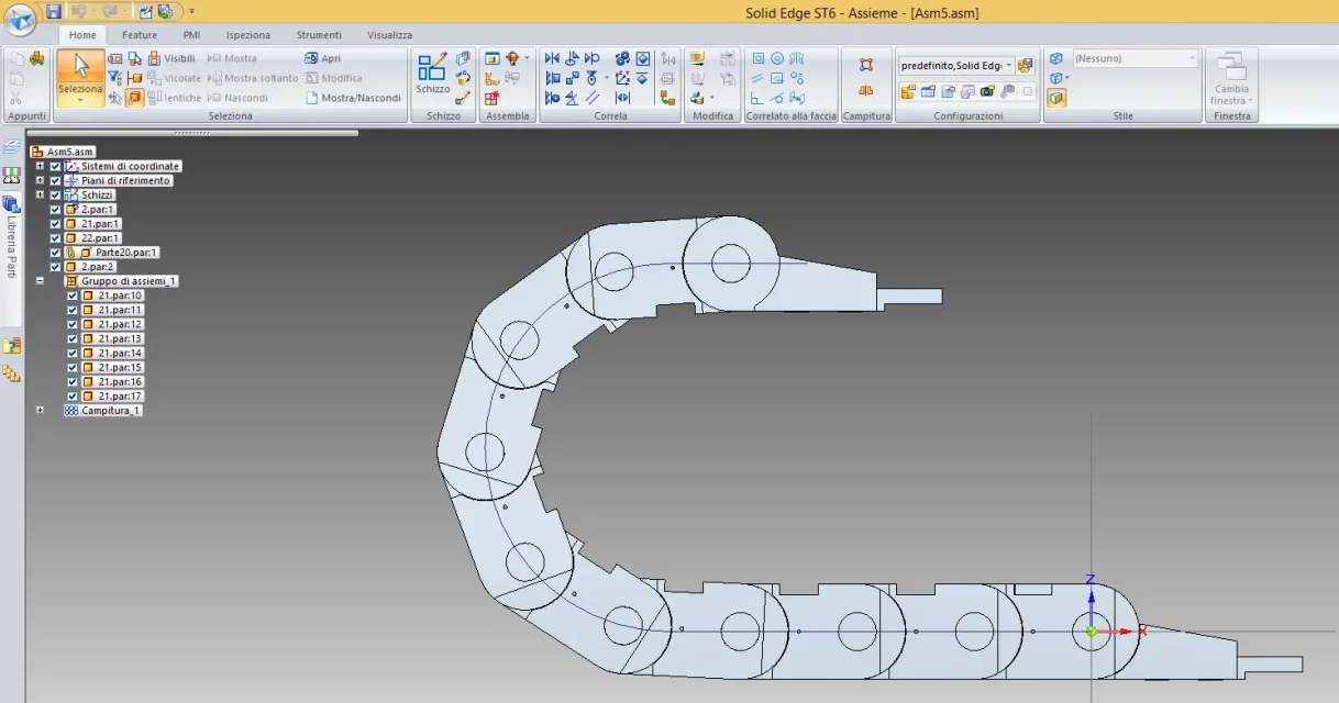

Hello everyone, I would like to create a parametric chain using the curved sample command, I attach the images to simplify the problem, I know exactly what the error is due but I don't know how to fix it.
in grey as it should be while in yellow that originated from the curved sample command.
the parametric is very convenient because it is easy to create it and it flows along a simple sketch.Screenshot 2014-11-19 12.26.02.webpScreenshot 2014-11-19 12.26.06.webpScreenshot 2014-11-19 12.26.20.webpScreenshot 2014-11-19 12.22.44.webpScreenshot 2014-11-19 12.23.00.webpThank you in advance.

the sampling along a "spalm" curve the elements on the entire length of the curve and the distance between the elements is measured on the curve itself. As a result, on the circular section, the chain mesh is measured on the arc between the two elements of the sample, while for this element the length of the arc between the two elements of the sample should be used. I don't think there's this possibility today using the sampling along the curve.
my advice is to insert a circular sampling to be used on these traits.
