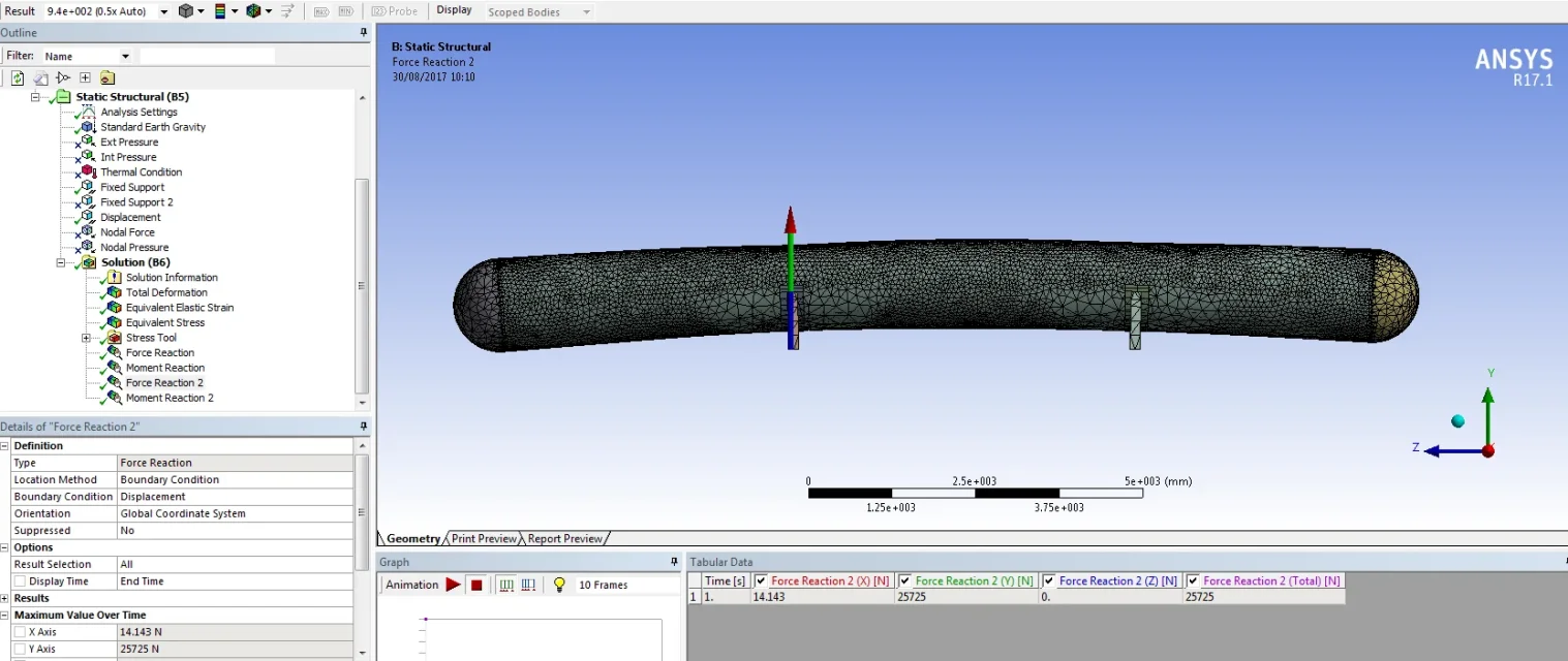

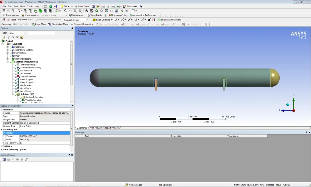

Hello, luca.
As you can see in the first image, my pressure vessel has the two supports not exactly the same distance. the material of the supports is different than that of the vessel and I have both inserted them manually in data engineering.
1.webpthe total weight of the body is about 36618 n, so if I insert only the force of gravity and the two supports, I expect that the sum of reaction forces in direction y applied to the base of the supports is equal and contrary to the weight.
in the following photo you can see that the force reaction (y) applied to the fixed support is 18456 n.
2.webpinstead on the following support I defined a displacement and the body is free in direction x and z while it is fixed in direction y.
In this case, force reaction 2 (y) = 25725 n.
3.webp18456 + 25725 = 44181 n
a very different figure than the weight of the body (36618 n).
At this point I tried to insert a nodal force in a very approximate manner to the center of the vessel and in this way reaction forces are exactly equal and contrary to the weight of the body.
I also tried with alternate geometries and get the same thing...
