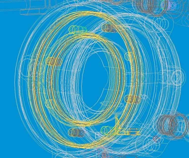

work on changes and other automotive details, since I installed st7 I can no longer import surfaces with "solid" display.
What settings do I need to change?
I attach an example, I only see the skeleton as an example below:
Superfici.webpThank you in advance.
go to the solid edge options, tab "view", put the check on "use shading on buildings"
I didn't fix it, nothing changes.
I do not understand why in the same imported set, some surfaces are displayed correctly and others only as buildings.
I have solved, thank you mythical!! If one day it happens I'll have a lot of beers, always very useful!
