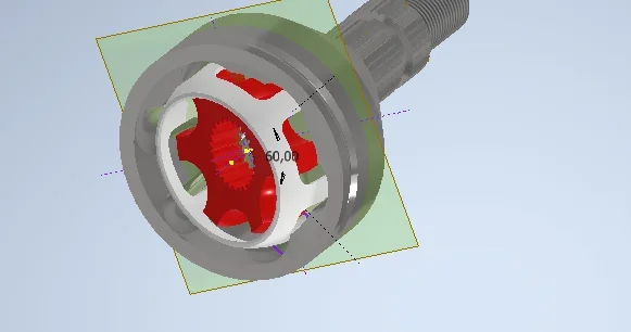

Hello I have a problem with inventor, I am making a homicidal joint and during the realization of the whole I am having great problems... in practice the central wheel, which in the photo you see in red, in needle moves as right that it is the problem and that also rotates... things that should not do, with this I can not even somehow bind a sphere

sincerely I have not understood much from the exposure, but if the problem is that it goes into interconnection, it has to activate the contact resolver, or use constraints as directed angle. with the bond may be inconsistencies.
writing in the inventor section would certainly have more use with regard to having answers.perhaps better curing the request, punctuation in primis, which is rather farraginous.
and perhaps, but I might be wrong, having the 3d model would help to understand how the constraints were set.
