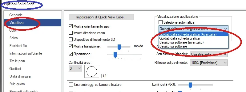

Do you use a low-end laptop? looks like a video card problem, try to go into the settings-->options-->display and choose a "based on software" mode.
general performance will not be excellent, but at least you can work with it.
