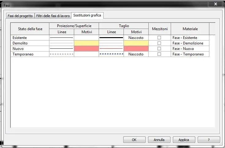

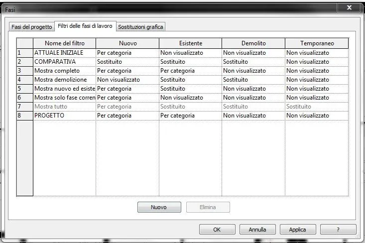

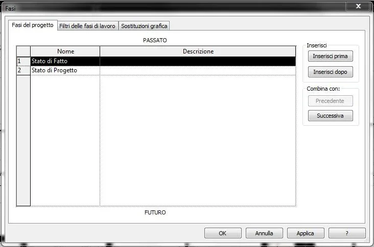

good evening to all, use revit for a few years but I have a problem with the stages.
I use them to manage the urban variants of a project: current state, design, variant. . .
I create phases, duplico le vistas, demolish the walls and make new ones.
I don't understand why every time in the previous phase I jump in, square meters open holes in the masonry where old and new walls meet, in short I spend more time adjusting the previous state than to make changes.
the same problem has my colleague and others I know have given up comparisons and phases creating multiple files.
I believe and invested a lot of time in the software and I would like to have a unique file with represented the whole history of the building without going crazy.
in the last Coptic, demolish and take everything in the new phase but losing the comparison.
Does anyone have any idea where I'm wrong?
Of course, in this case there is only current state and project but the filters are these.Cattura.webpCattura1.webpCattura3.webpCattura4.webp

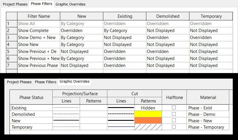

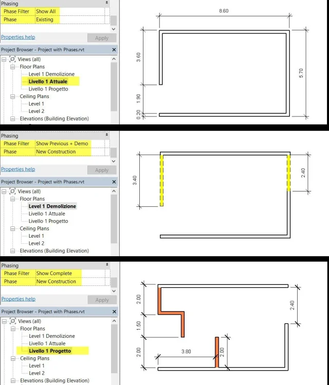

and a combination of setting. I would. see the image.
If I try, I bet that if I demolish the vertical walls, I'm also missing a corner piece.
