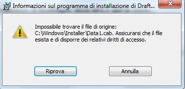

I'm trying to install draftsight 2018 but in the installation phase I get stuck by giving me the message:
"Impossible to find the source file: c:\windows\installer\data1.cab" as from image.
data1_cab.webpHas anyone already happened or do you know how to solve it?

I also tried to make a repair of the installation of win7 pro, other programs me install them without problems... I would also have to have an older version but I find it
if you have downloaded the package with a browser like chrome it is written on the site that is not good and use ie otherwise it could be corrupted the package.
