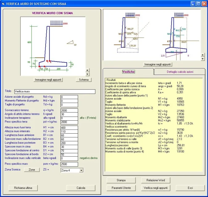

I wanted to report the program on the calculation of the ice cream support wall. is free and you can download from the following site.http://dicata.ing.unibs.it/gelfi/software/programmi_studenti.htmlI inform you that there are several programs on the site for calculating structures.
are reliable programs and, now, known and also professionally used by strutturists.
together with the programme are examples developed step by step, from which the process adopted can be understood.
It comes a great help for those who know how to plan and want to make a personalized program.
I, through the program walls, developed the following application based on the program gelfi.
