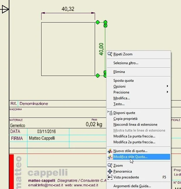

I would like to know if with inventor, during the table (dwg, iwd), or any other phase, if you can change the quotas, setting that, the first digit after the comma, is displayed only if different from zero, while if equal to zero, it is not displayed.
and even if you can save this setting, making sure that to each new part, it has in the quotation this setting - or others, in case it is not possible as I mean-.
Thank you very much to all in advance.
it is possible to do it through styles
after listing, the + simple thing is:

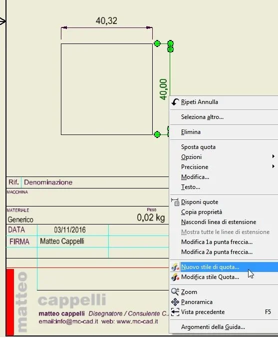

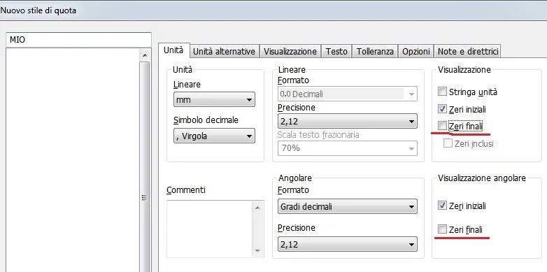

select the quota , button dx, select "new style quota"_foto__279.webpat this point you are within the editor of styles; enter new name quote style (my) and delete the spuns on the options of "zero"_foto__280.webpof course in the other cards, it is possible to perform all customization quotas (like the ddim command of autocad)

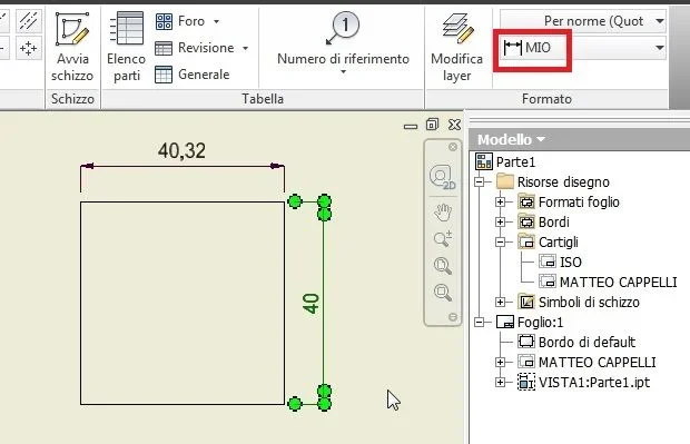

after saving, the quota is updated (style name, visible from the annotation menu)_foto__281.webpin case you want to save the settings, just save the table (private drawing) as a templete model.

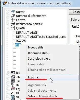

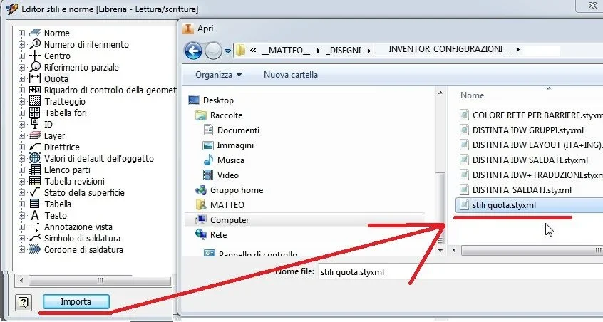

if you want to update the quote style on drawings already made, just export the settings and then re-import them in the tables "old"_foto__282.webp_foto__284.webp
