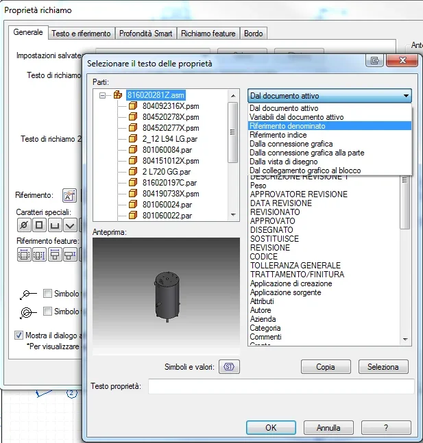

the part after the "|" symbol is the reference from which the property is taken.
r1 indicates that it is taken from the first part or together inserted in the drawing. (r2 from the second and so on).
If you want to recall on a specific part also nested you must use a "appointed reference".
the syntax changes but with the property insertion tool you go to insert choosing from a graphical interface and therefore it is not necessary to remember the syntax to memory.
ciao

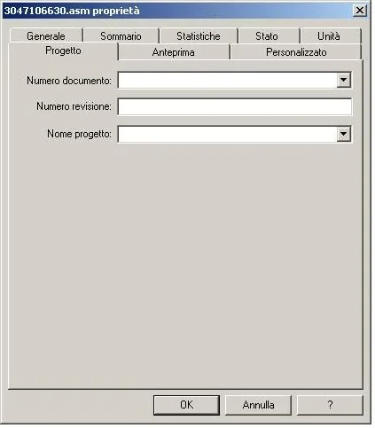

Proprietà.webpHi.
thanks to the answer, but I wanted to insert
the "filename" property within the part or
together in the mask "document name" in
so you should not rewrite it by hand.
View attachment 38825Hi.
