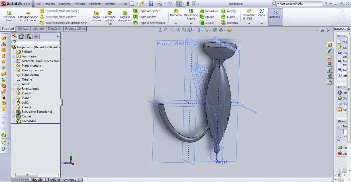

1523533_10202370249210706_485156300_o.webpYou're right.
then modeling is solid, not for surfaces, and the function selected for repetition is ''corpi''
It is not a multibody part first. then if you repeat the body you will also find n central stems; at the visual level nothing changes, but logistically and if you have to get the weight the difference does.
However, with that image, you just remain in the dense Paduan fog. the image of the feature manager of the repetition would help but if there are problems of construction you only understand from the file. if there are copyright issues simplifies the forms, but post the file, because otherwise you go for attempts and maybe to solve a problem of 2 minutes you put 4 days.

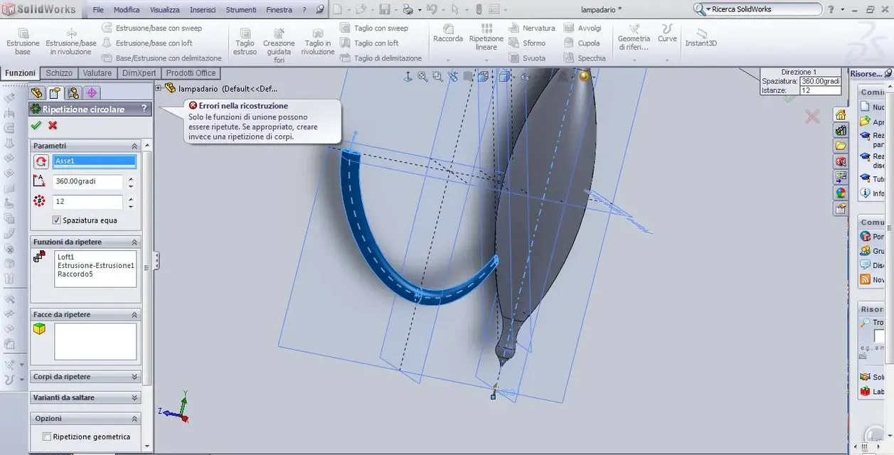

Here is the file you need.... I also attach the repeat screen to show you the error that comes to me1147081_10202371259555964_352865614_o.webp
then the repetition is functions, not bodies like you said.
in the guide, this unknown, there is writtengeometric repetition creates repetition using only the geometry (faces and edges) of the functions, rather than repeat and resolve each instance of the function. geometric repeat option accelerates the creation and regeneration of repetition. It is impossible to create geometric repetitions of functions that have faces combined with the rest of the part.so just put the tick to that option and the repetition works.
a stroke of ears is necessary; would be useful to give correct information:
talk about uneven surfaces instead the error message says union functions
talking about repetition bodies instead is a repetition of functions.
