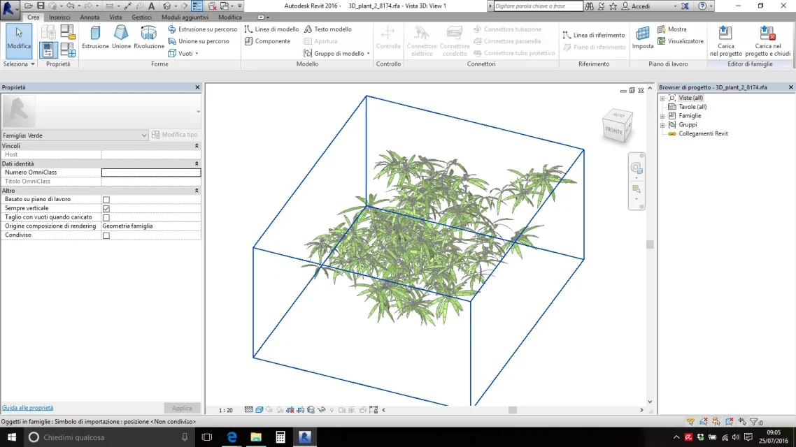

So, after some tests I realized what it depends on.
loading a 3d view in the table begin slowing down.
in the project I needed to insert the hedera on a pergola.
naively I imported a cad item downloaded from the internet.Screenshot 2016-07-25 09.05.02.webpI tried to hide it in the display and everything works great.
At this point I ask you if you have families revit of edera to be able to pass that they are not simple cad blocks.
