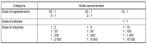

in drawing 2d it is correct to use drawing scales that are not 1:1/1:2/1:5/1:10/1:20 etc. etc.
type for example 1:1.5/1:3 or others.
Thank you in advance.
always preferable to use ''Classical' scales, because also the operator has appropriate tools (scalimeter) .
1:3, 1:4, 1:7 And so forth would be, of good creation to be avoided.
to use would be preferable the following:
regulations prevent the use of standard scales. if different just emphasize with a line.
we often use 1:3 and 1:7 etc.
my prediction that they do not take measures from the sheet.... although often in the civil field it is still used.
